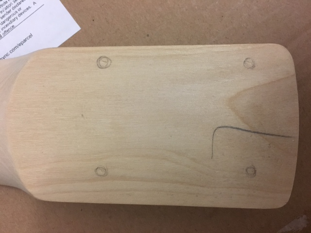

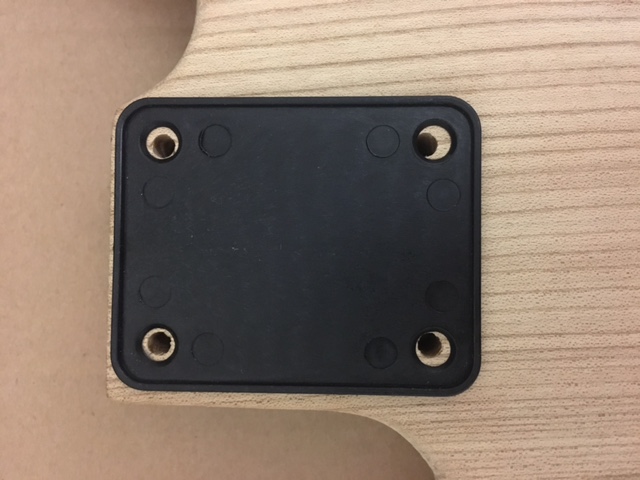

Ive done a fair amount of sanding to get the neck to fit the pocket, and I'm finally happy with it now, but i do have an issue with the pre-drilled neck cavity. Somebody who drinks more than me had their way on this one in the factory. The holes do not line up with the neck plate. And even if they did, they are too far off centre for my comfort. On the bass side I only have 5-6mm from the edge of the neck to the centre of the screw, which i fear may lead to the wood splitting etc.
So Im going to have to plug the holes and re-drill. Given I have next to no wood working experience, and almost no tools, can some one wise please suggest my path forward? i.e. where can I source 4mm dowels? is PVA wood glue sufficient, or should I use titebond? Any other tips and tricks I should be aware of?
