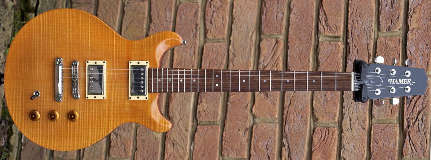

I've got a Hamer Artist which is quite a similar shape to the PRS. The back's about the same colour as yours.
Attachment 22346
Its top has a great flame, but it's not really brought out like it could be. In most lights you can't see the flame from any distance. But had it been popped so that the flame was much stronger, it would have a superb look.
