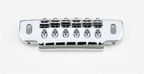

2. It depends on the type of wrap-around bridge. You've got your basic rounded top (very original but never great for intonation), one with pre-set raised sections to give you better intonation, or one with fully adjustable saddles, such as the Gotoh 910 shown here:
Attachment 21555
This will give you the same adjustability as a tune-o-matic would.
I've got a pre-set wrap-around on my Gibson Music Maker Les Paul and with 10s on the intonation is pretty good. Not out by enough to worry about. No idea how that sort would be on an open C tuning, especially if you used a mixed set of strings to balance the tension.
