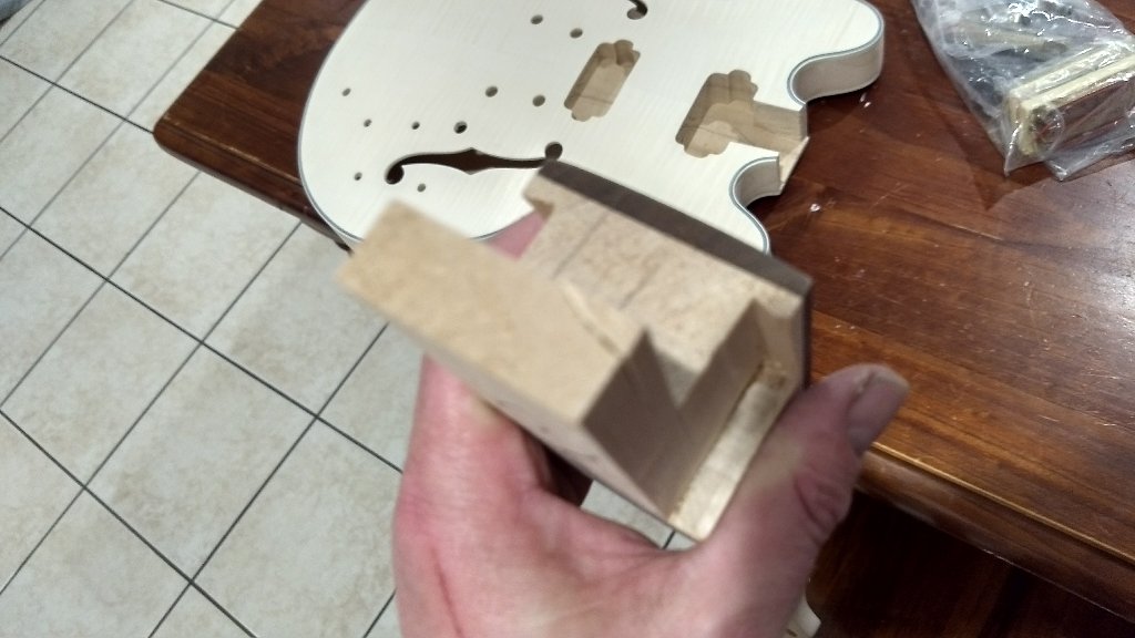

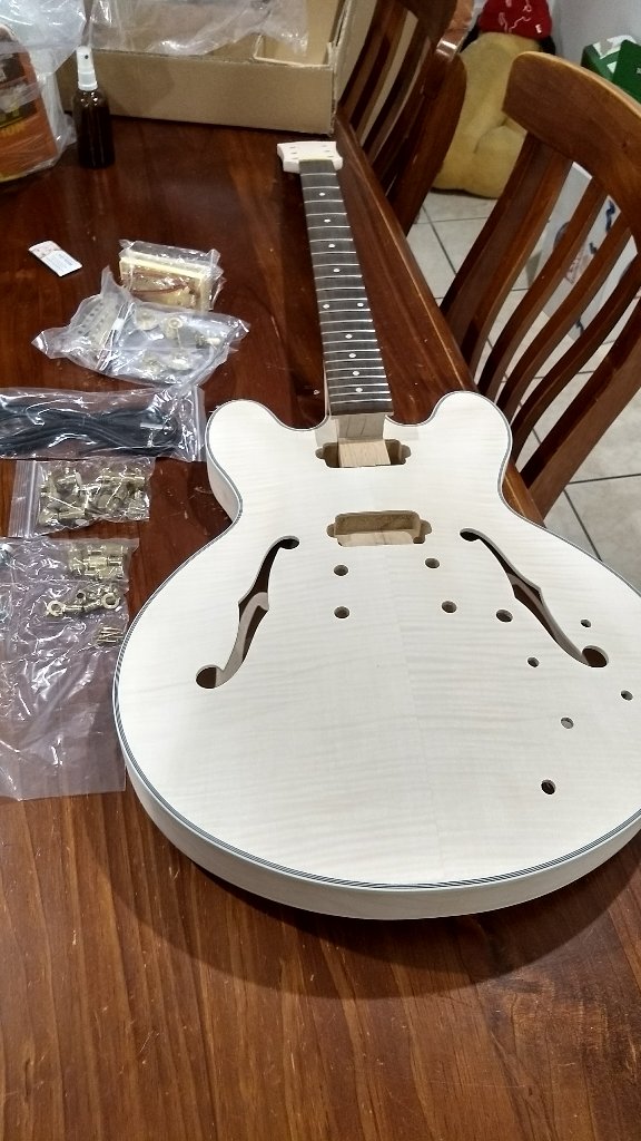

I just unpacked this little beutie, however there is a small crack in the neck. I did purchase this on ebay, from PBG.
Attachment 21034
It seemed pretty tight, anyway, so I didn't want to push it before I started sanding it.
Attachment 21035Attachment 21035
A shame about the crack but you should be able to squeeze some glue into it and clamp it together. You've still got most of the tenon intact, so there's no significant weakening of the joint as a result.
these always come up well, nice kit. I agree with Simon - glue clamp, and move on, all good
Too bad about that crack... Nothing that some glue won't fix but it just shouldn't be there...

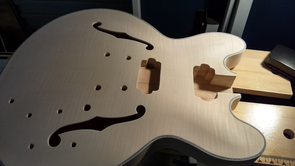

Attachment 21265
I sanded the body back yesterday, though a mark started to appear just above the Neck pickup.
looks good HBG. Remember to only lightly sand the flame maple veneer is paper thin !

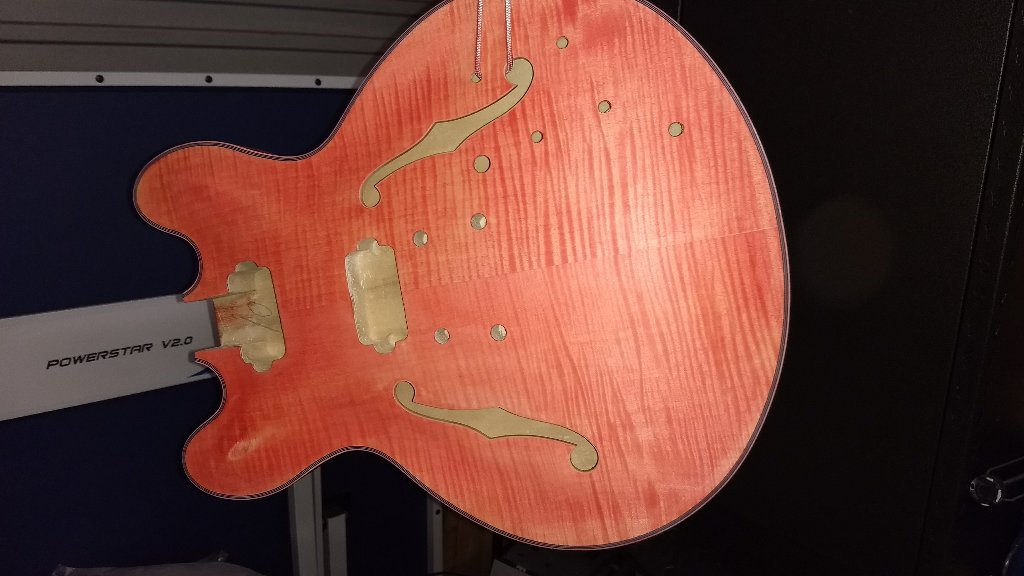

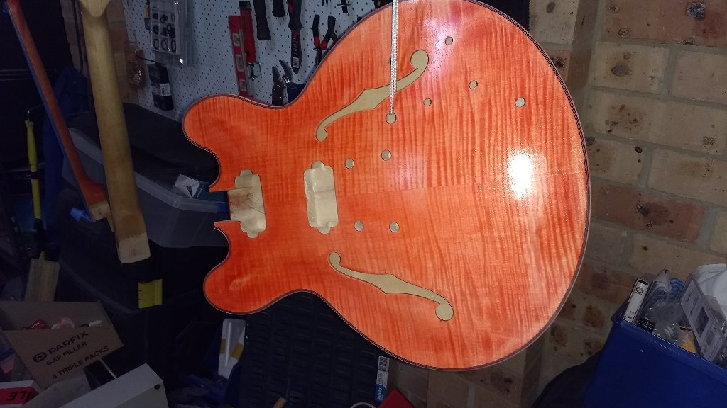

Attached are the 1st and second coats of Uluru Red.
1.
Attachment 21452
2. Attachment 21453
The second coat seemed to attract a bit more dust.
colour looks great HBG. Bummer about a few glue spots on the veneer
