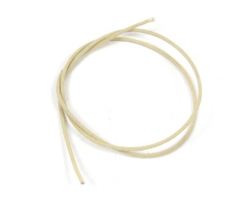

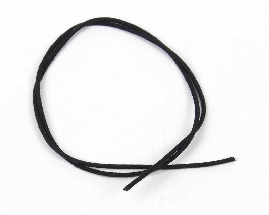

I usually use the cloth covered stuff because you don't have to use strippers on it, just push back the cloth.
thanks dedman. the good news i got the tools for stripping the wiring and that so yeah thats no issue. but not sure does the wiring make a difference? i was going to swap the pots and i thought while im in there upgrade the wiring. i know that in moat case a better thicker wire is better jusy wasnt sure if it was the same with guitar wiring.
i also noticed that the tonerider pickups are not as hot as the entwistle ones. but everyone recommends them. i have got toneriders in my strat and love them but i also have entwistle dark stars in the flying v and love them also. its really hard to choose now these days and its only 2 brands im looking at. lol
Hi Brokin, Tonerider have more PUP's to pick from when compared to Entwistle but they do cost a little bit more. Most come with 4 wire, same as Entwistle which allows for coil splitting and other funky wiring options.
As for upgrading wiring, I think most folks are referring to electronic components such as pots & caps, switches, and also using cloth covered wire as found on the PBG store site. I have used the wire on a couple of builds and tempted to re-wire everything with it as it is such a better grade of wire and so easy to use.
https://www.pitbullguitars.com/shop/...e-black-500mm/
https://www.pitbullguitars.com/shop/...e-white-500mm/
