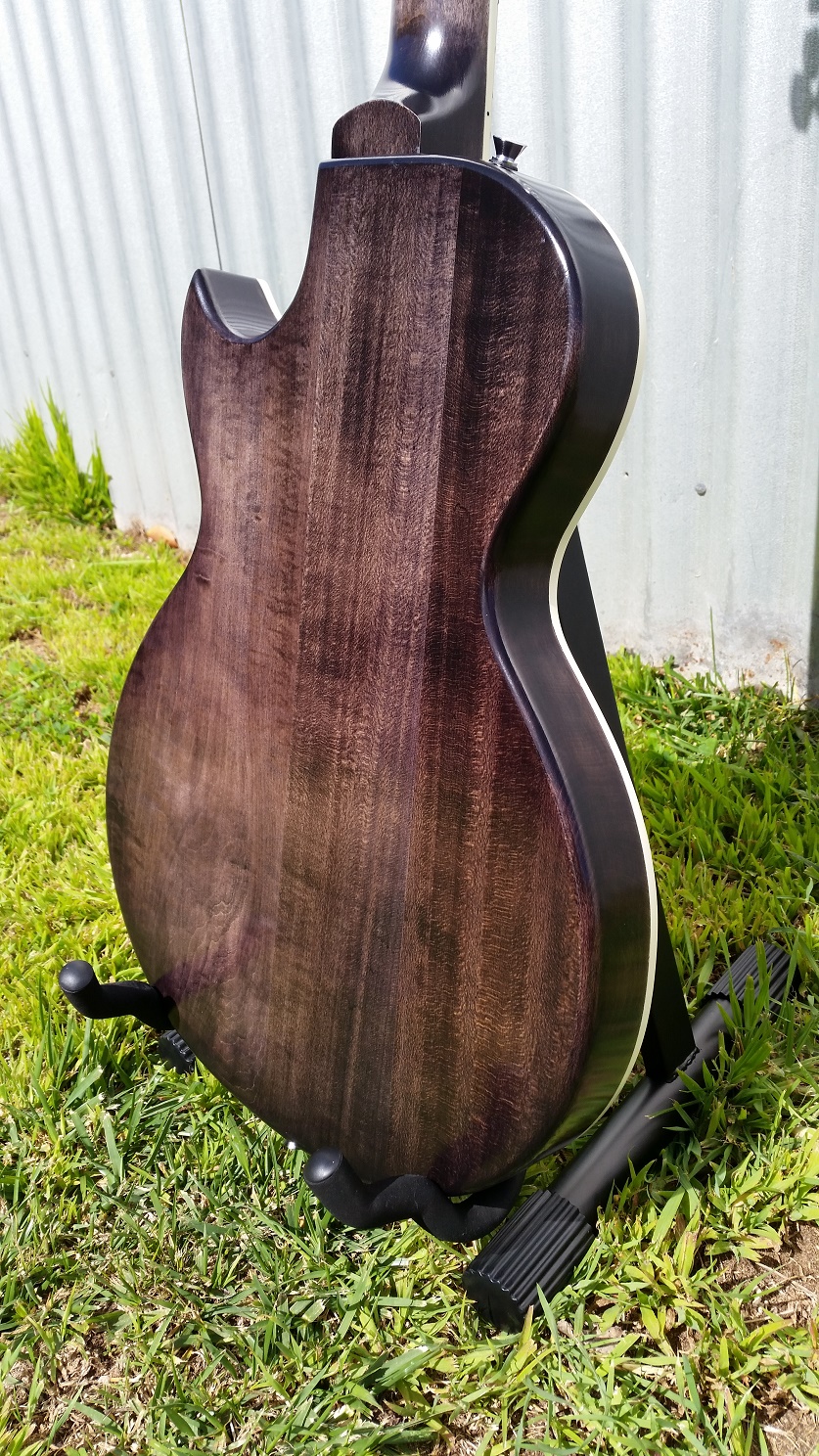

About the only advice I can give is DON'T sand the timber with too fine of a grit paper before you start to apply the Wudtone, P220-240 is where you want to stop if you're after maximum blackness (and who isn't?).
I used the same product on an ES-2V kit, maple neck basswood body, and made the mistake of sanding up to about 600 grit thinking it would give a smoother finish at the end. It did give a smooth finish but as you can see the colour didn't take as well as hoped. My mistake.
Attachment 19972
Oh, and use 1500 - 2000 grit to scuff between coats in lieu of steel wool, better yet use micromesh sanding pads.
Hope that was some help.
Grant
Chit--down to 1000 grit already !
Did you have to rough it up or did you just keep applying. I reckon 10-20 coats does that seem about right?
