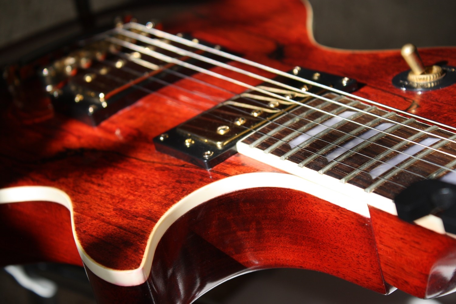

1 Attachment(s)
Hi Milty, the neck angle on my LP1-SS looks like this
Attachment 19823
I should say that i did almost no modifications to the neck heel or neck pocket. Its pretty much PBG standard
