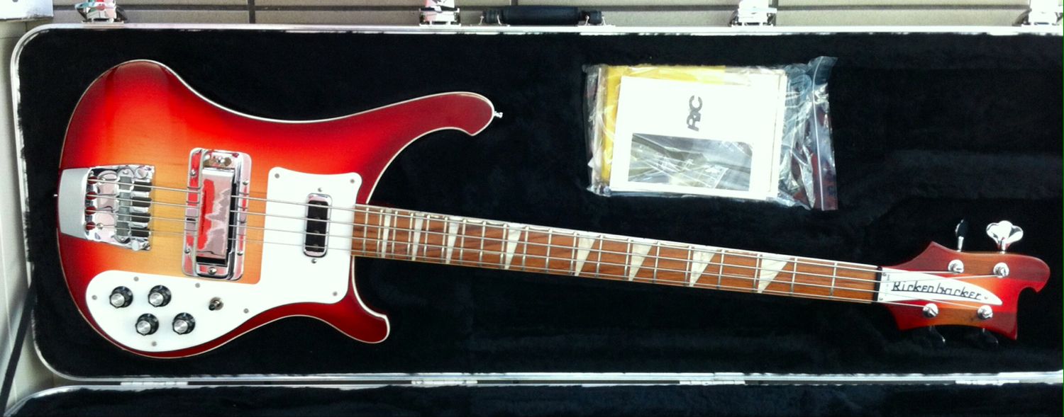

I want to build a bass that outputs 2 completely separate, active signals - one to send to a bass amp and another that I'll probably put into a guitar amp. I'm thinking that I need to do this through a stereo cable output from the bass which splits into two mono jacks. However, I'd also like an alternative option of just using a normal mono output that brings everything together into one signal (if I only have 1 amp available or forget the stereo cord). This setup is based on the "Ric-o-sound" setup from Rickenbacker that uses 2 jacks, one stereo and one mono, and you just plug into the one you want. But if there's another way to do it any suggestions are welcome!
