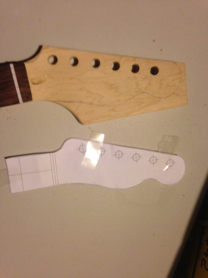

Pic of the headstock and template I used
Attachment 19334

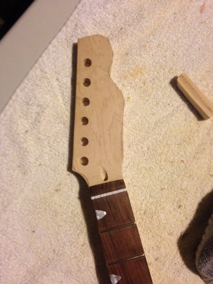

Rough cut of the headstock with a jigsaw
Attachment 19335

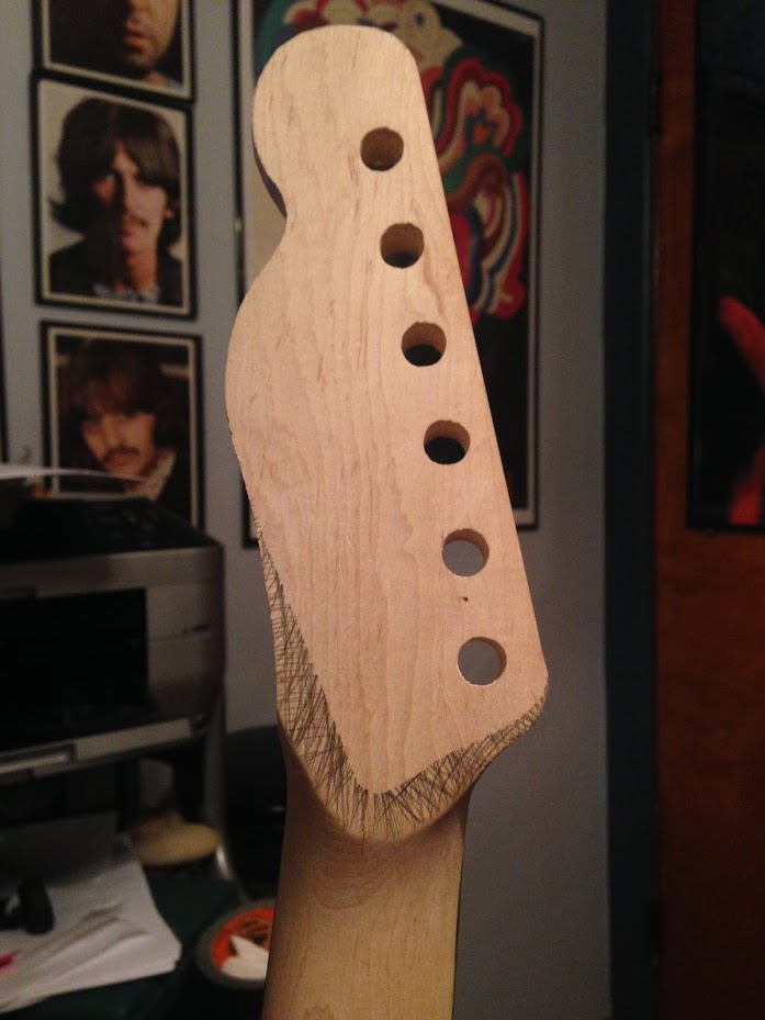

Rear of the headstock pre shaping, penciled in areas were removed and was squared off
Attachment 19336

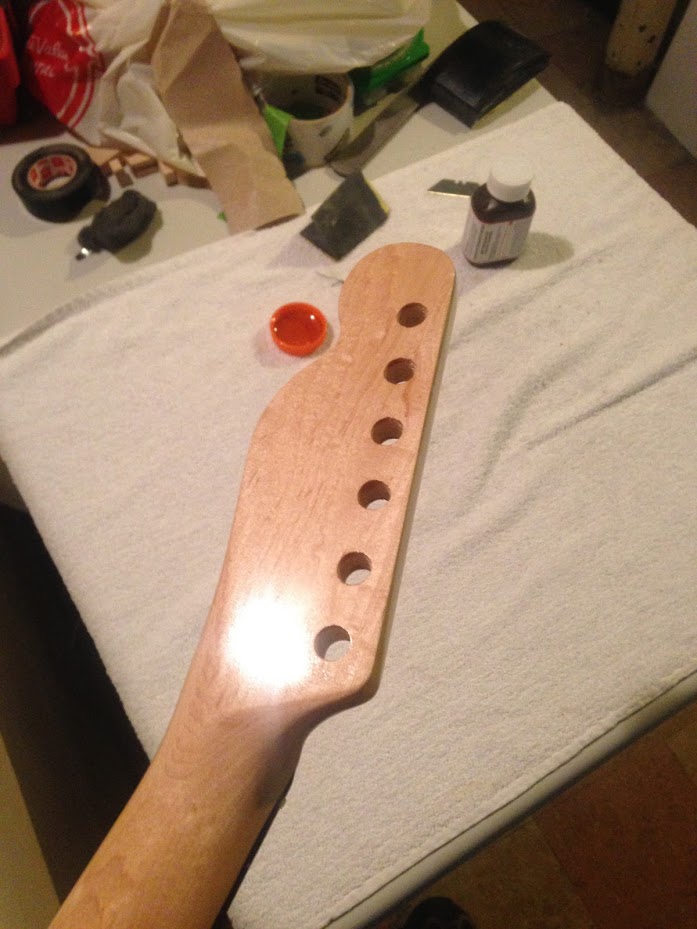

Rear of headstock post shaping
Attachment 19337

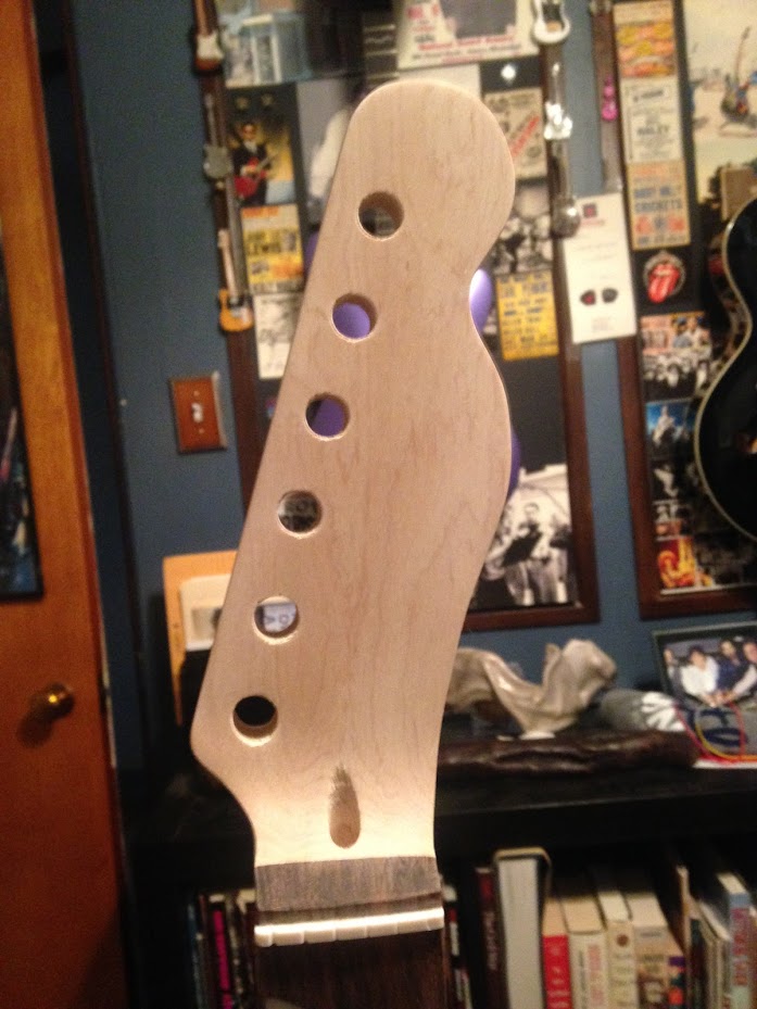

3 Attachment(s)

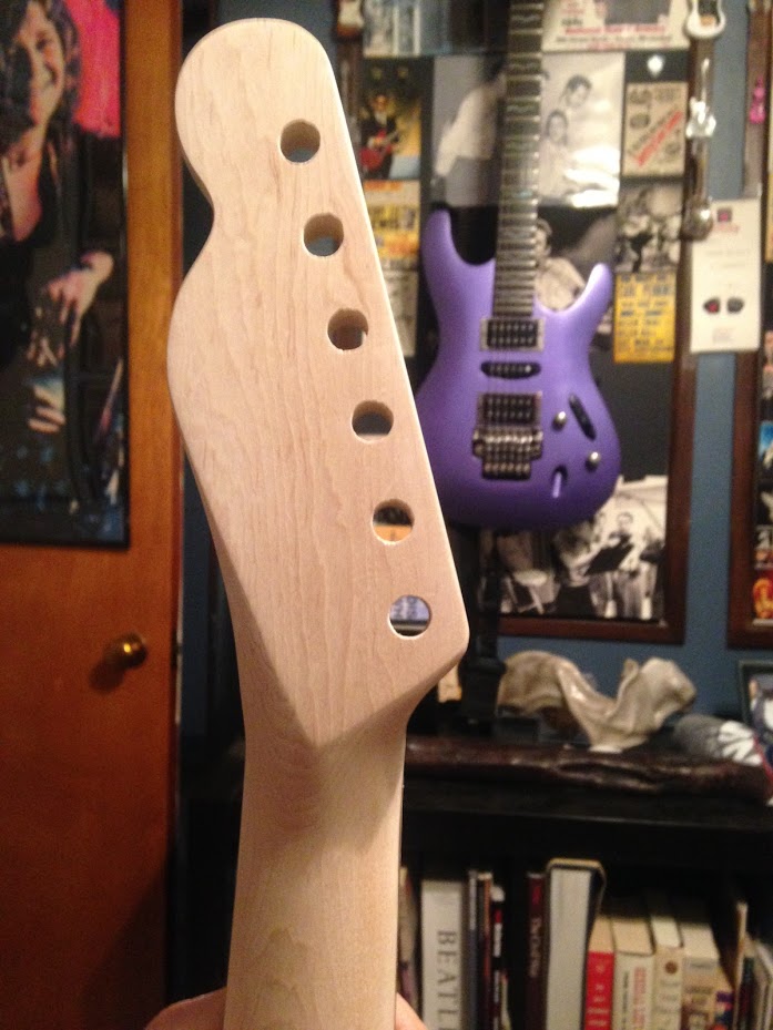

Attachment 19338
Front of headstock with 5 coats of truoil

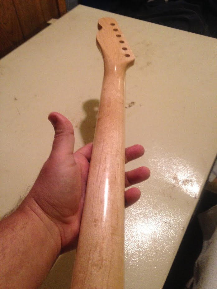

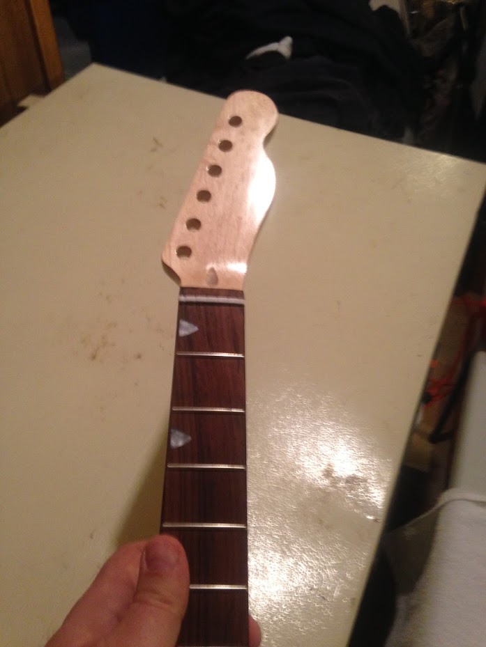

Attachment 19339
Neck with 5 coats of truoil
Attachment 19340
rear of headstock with 5 coats of truoil
sanded to 600 grit prior to application of truoil
and 0000 grit steel wool between coats of truoil
