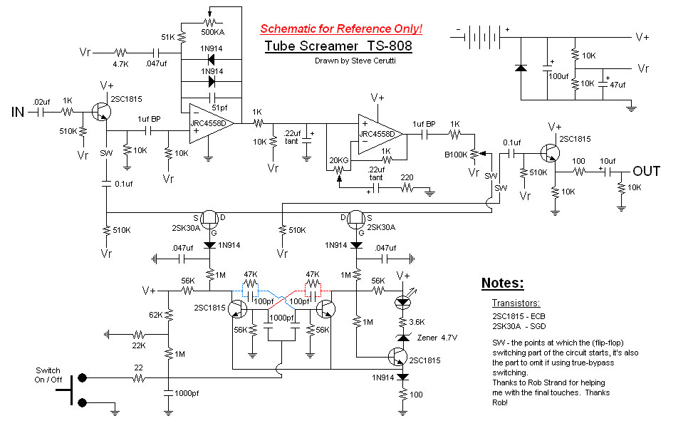

While looking at all the components on top of the circuit board with my magnifying glass, I noticed some whitish-looking substance underneath a small ceramic capacitor, one terminal of the capacitor was connected to a resistor that connected to one of the contacts of the foot-switch, the other terminal of the foot-switch was connected to circuit-ground, on a hunch I grabbed my digital multimeter, set it to the 20M resistance range, and measured the resistance of the capacitor, which should have measured close to infinity, it actually measured about 7.5 kilo ohms, that looked very suspicious to me, so I tried de-soldering the capacitor and then scraping away the whitish substance with a Stanley-knife blade, then I soldered the cap back into it's place on the circuit-board, result....that fixed the foot-switching malfunction completely and now the foot-switching reliably functioned as it was supposed to.
