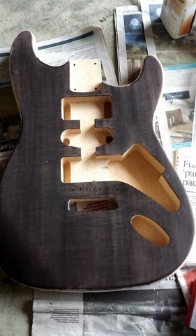

The first coat of dye was applied the following day. I used two coats Briwax's brown mahogany spirit based dye for the neck and body, sanding with 240 grit between coats. Here is the front of the body after the first coat.
http://www.buildyourownguitar.com.au...3&d=1482973665

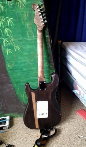

I felt that having the entire body dyed dark was going to be a little uninteresting, and I added an accent line of bare wood to the back (you'll see it in the finished pics)

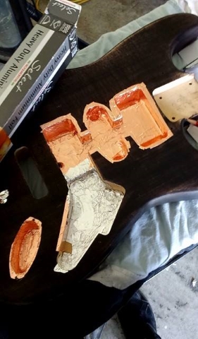

After the buzzing horror that is my P-bass-ish (I got radio through it once, not my preferred station though), I wanted to ensure that my new guitar would not have the same issue, so I bought DingoBass' shielding kit and went to work creating a Faraday cage. Unfortunately I ran out of copper tape, and couldn't be bothered to wait for the extra tape promised if it was not enough, so aluminium foil and a glue stick finished the cavity shielding. Picture is of the mostly finished shielding. I also added a layer of aluminium foil to the back of the pickguard that makes contact with the overlapping edges of the cavities (I'm not sure if this is necessary but I'd rather over-do it than under-do it).

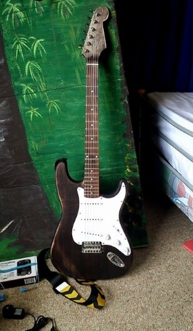

Now that it's all together, I think it looks great!
http://www.buildyourownguitar.com.au...5&d=1482975203
http://www.buildyourownguitar.com.au...6&d=1482975203
Plays like butter, other than the one fret that's high, but it is only an issue across the first three strings (E, A and D) and the last three play fine, any ideas as to why that is are appreciated.
Thanks for reading! :)
