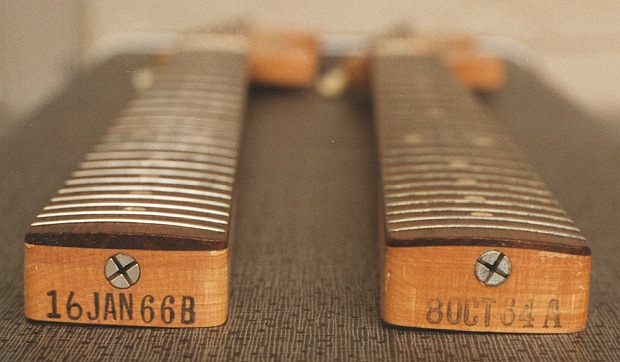

'Slab' on the left, 'Veneer' on the right:
Attachment 15320

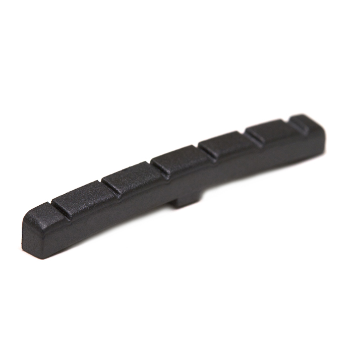

Curved nut with tang:
Attachment 15322
