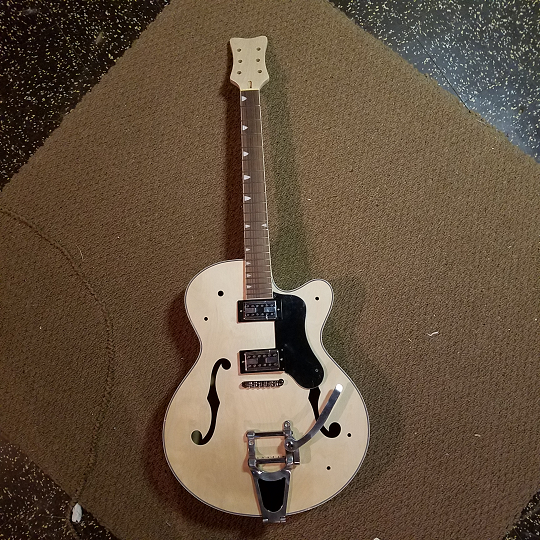

Getting started on the mock build ...the kit looks awesome.
Attachment 15189Attachment 15190

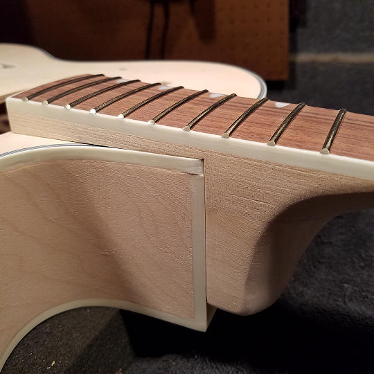

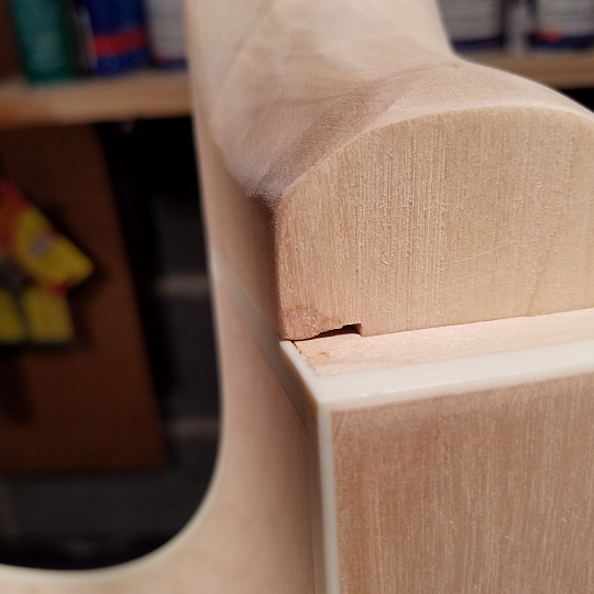

The neck fits in very nicely - there are a few angles by the heal that are not flush:
Attachment 15191
Attachment 15193
Curious about the best way to work with this. I'll send a pic of the other side in the next post.
Thanks,
Eric

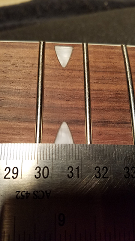

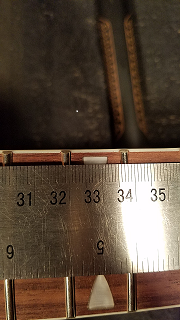

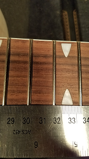

4 Attachment(s)
Questions about neck measurments
Hello,
Checking in on neck measurements to make sure I have this right. From the saddle to the 12th fret - I am coming up with ~328 mm on the low E and 324.5 mm on the high E. Saddle are forward on both.
Attachment 15423 Attachment 15424
From inside the nut to the 12th fret, it is about 303-304 mm.
Attachment 15425
Are these ok? I took from the instructional videos that these measurements should be closer to each other.
Some pics earlier in the thread show some gaps in the neck cut. Not sure if that plays into this.
I also do not have the posts for the bridge fully in at this point (about 1/3 in). Should I be tapping them in and should they go all the way in at this point in the build?

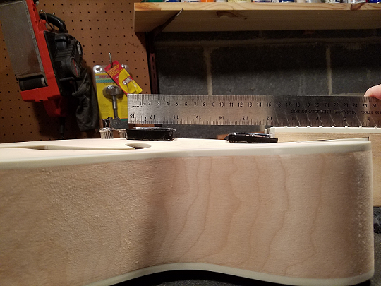

Final picture is a straight edge along the neck. Does this angle seem ok?
Attachment 15426
