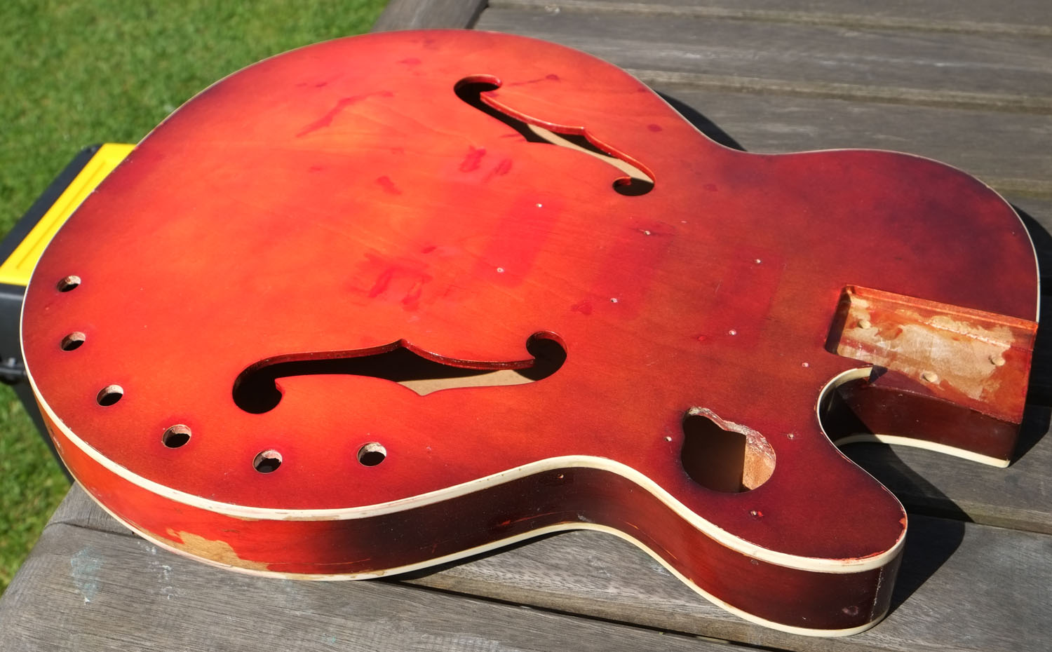

Last year a friend of mine stated an interest in getting hold of a '60s Harmony H-59, so I was looking on eBay for him when I came across a fairly beaten-up example of one in the US that due to its condition, was going cheap. I imported it, and as my attempts to touch-up the fairly damaged paintwork were only part-successful, I decided to strip it down and refinish it. Here's the original body:
Attachment 14771

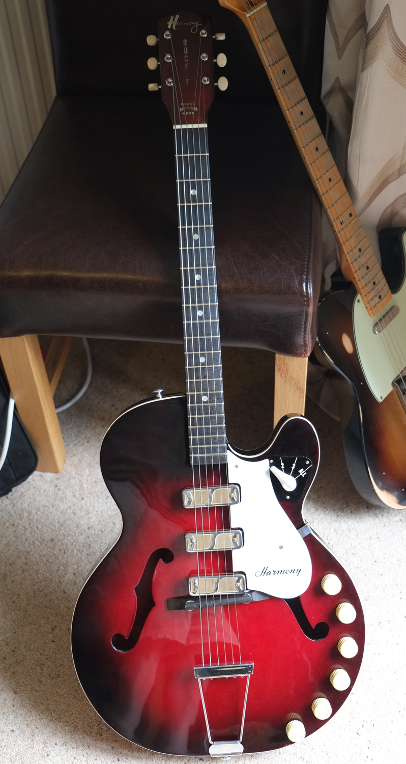

I used cellulose rattle-cans to repaint it, and was very pleased (as was my friend) with the end result:
Attachment 14772
However, I encountered various problems with inconsistent paint quality with the cans (some fine, some too runny, some too solid and tending to deposit blobs), which caused me a lot of re-work, so I vowed to get a proper air compressor and spray-gun for the next time I did anything like that.

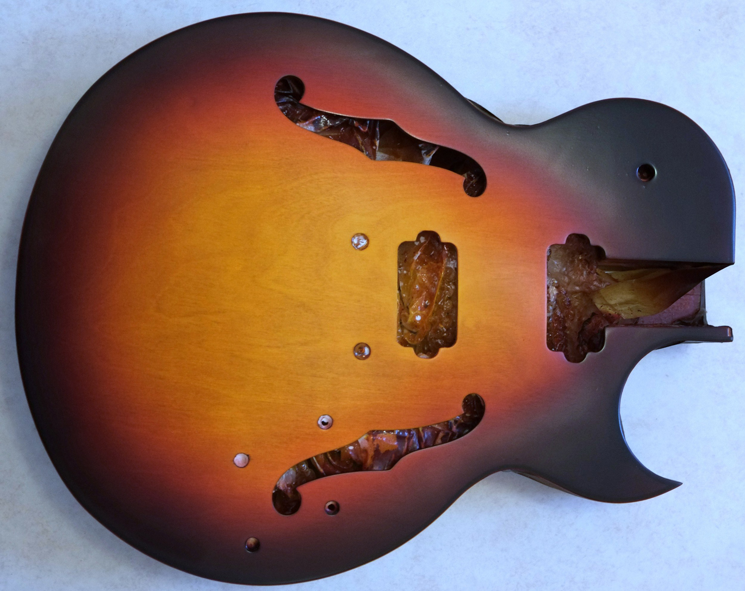

I'm at the stage of having sprayed the colour finish on the top and back of the body, and am about to spray the body sides tobacco brown (the top has been sprayed twice because I was careless and scratched right through the original sunbursting and my repair spraying looked awful . The neck has its colour finish applied on all but the top face of the headstock, which is nearing completion (took me ages to decide what to do with it). I then plan to glue the neck on, fill in any small cracks around the neck joints, touch those up with paint so that the neck/body colours match at the join, then spray on the clear lacquer coats.
Here's the top (I'm pretty pleased with this Mk2 version as it's just a touch better graduated than the Mk 1):
Attachment 14773

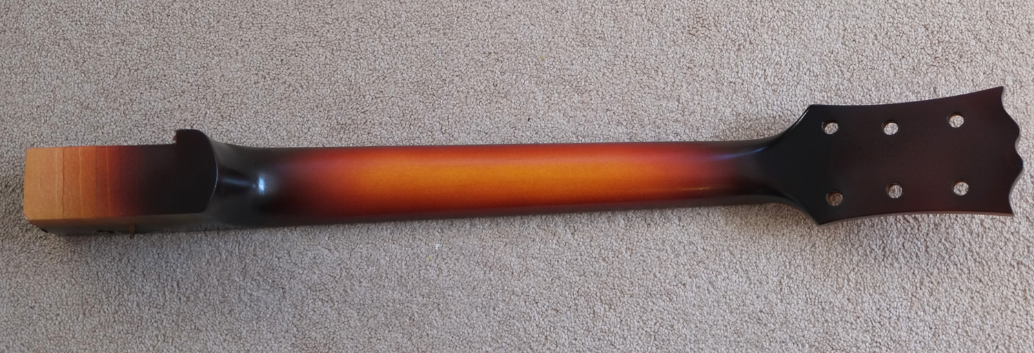

And here's the back of the neck:
Attachment 14774
As you can see, I've gone for a Gibson-ish headstock shape, without it being a close copy. The face has an triangular art-deco style MOP shape on it (they seem to be popular on here) but I have no plans to add any lettering.
