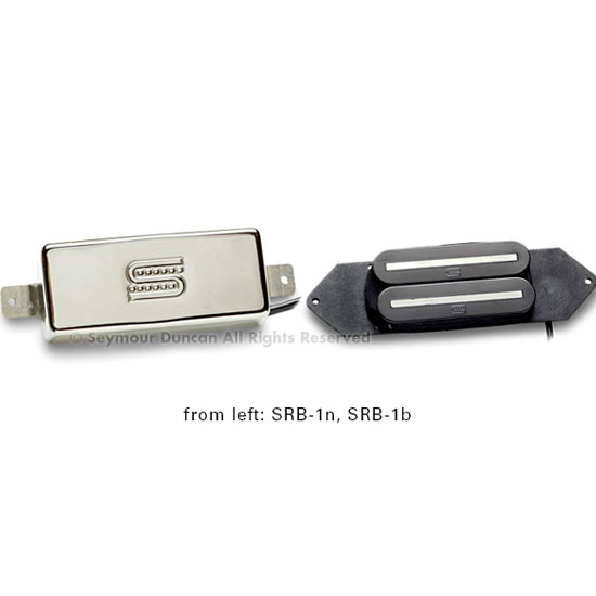

Thanks Waz. Yea I figured it was weird that SD recommended a guitar pickup for that reason too. I figure that the cheap ebay pickups would be the same as what the kit comes with or certainly no better. I will wait and order the kit and find out what size they are, they look like they fit in a standard humbucker mounting ring, not sure if any other bass pups do. And I want chrome covers like the originals
Looks like the Ric SD's might be the only way to go if you are chasing chrome covers
