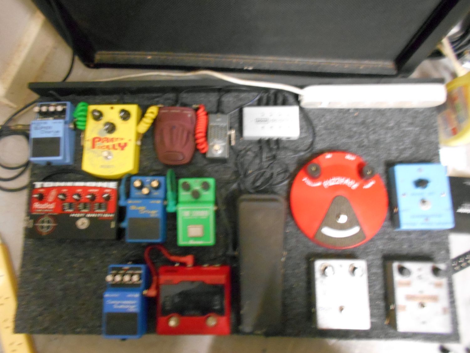

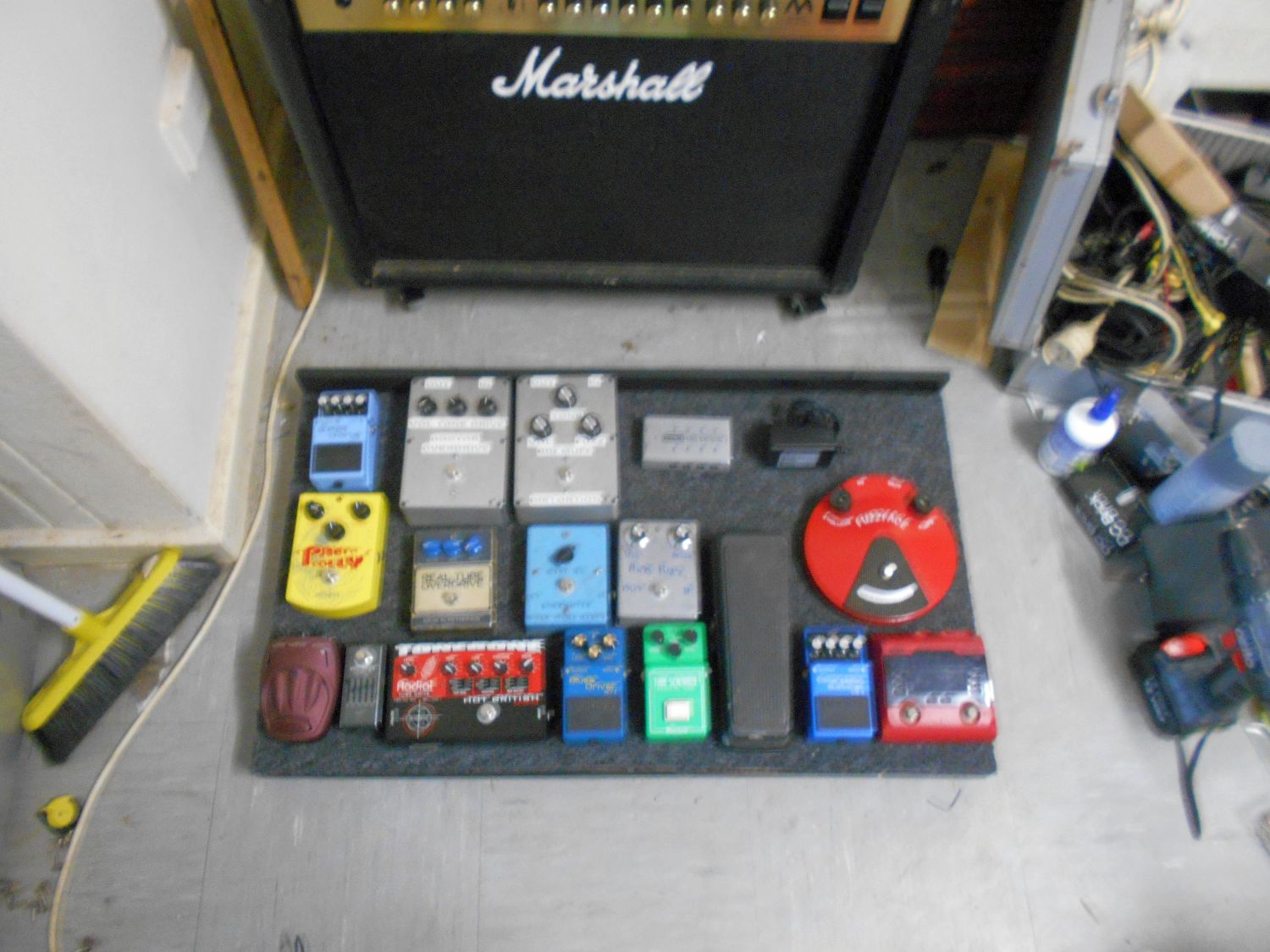

Thought I would get the ball rolling and start a thread about a custom fx pedal board I'm going to be making this fortnight, okay, so what is a pedal board and why do we need one?, a pedal board is simply a board of convenient size that you put all the pedals you use on in a logical arrangement so that it forms a single neat package, I believe every guitarist needs some kind of pedal board because it will make setting up onstage that much quicker and efficient.

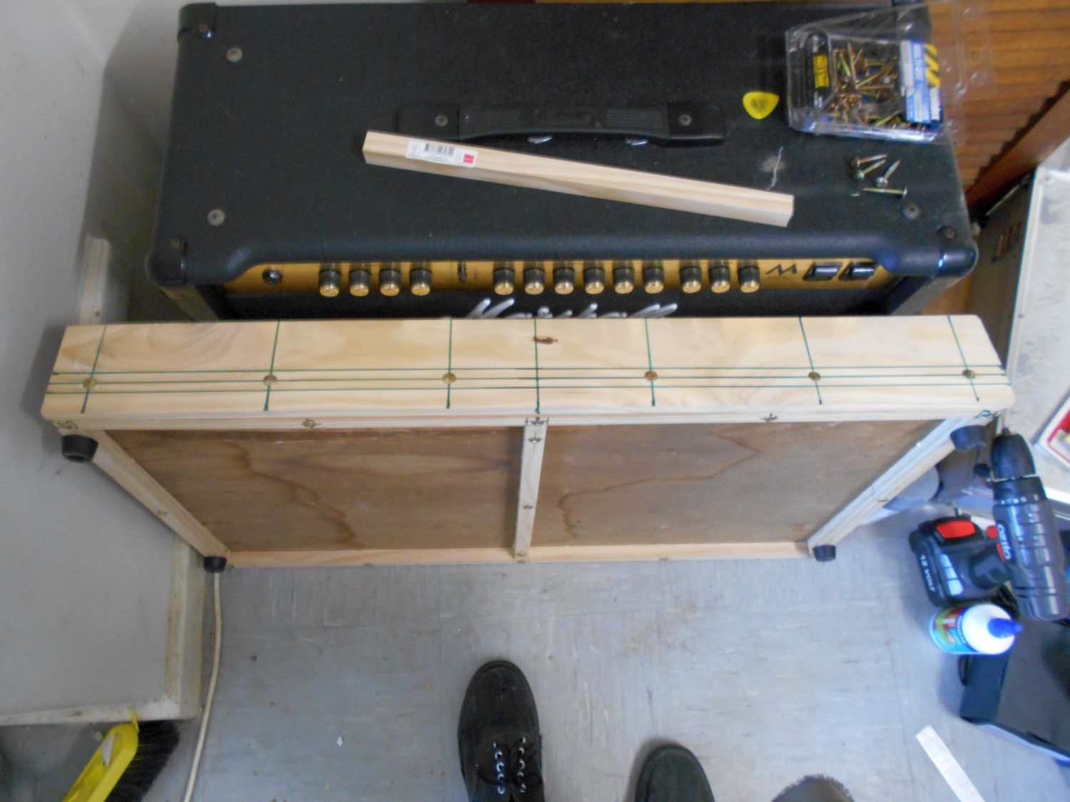

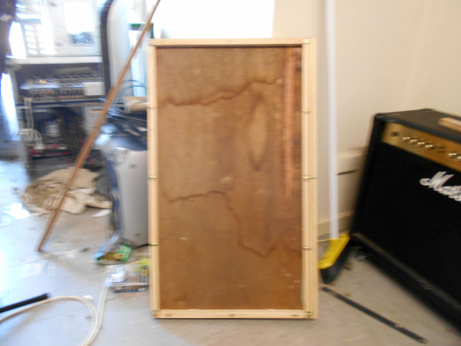

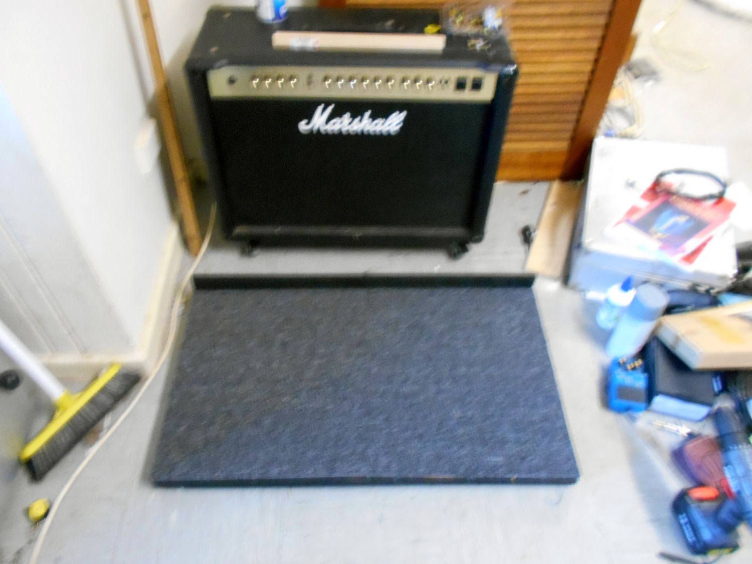

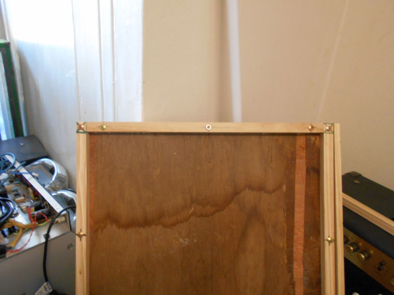

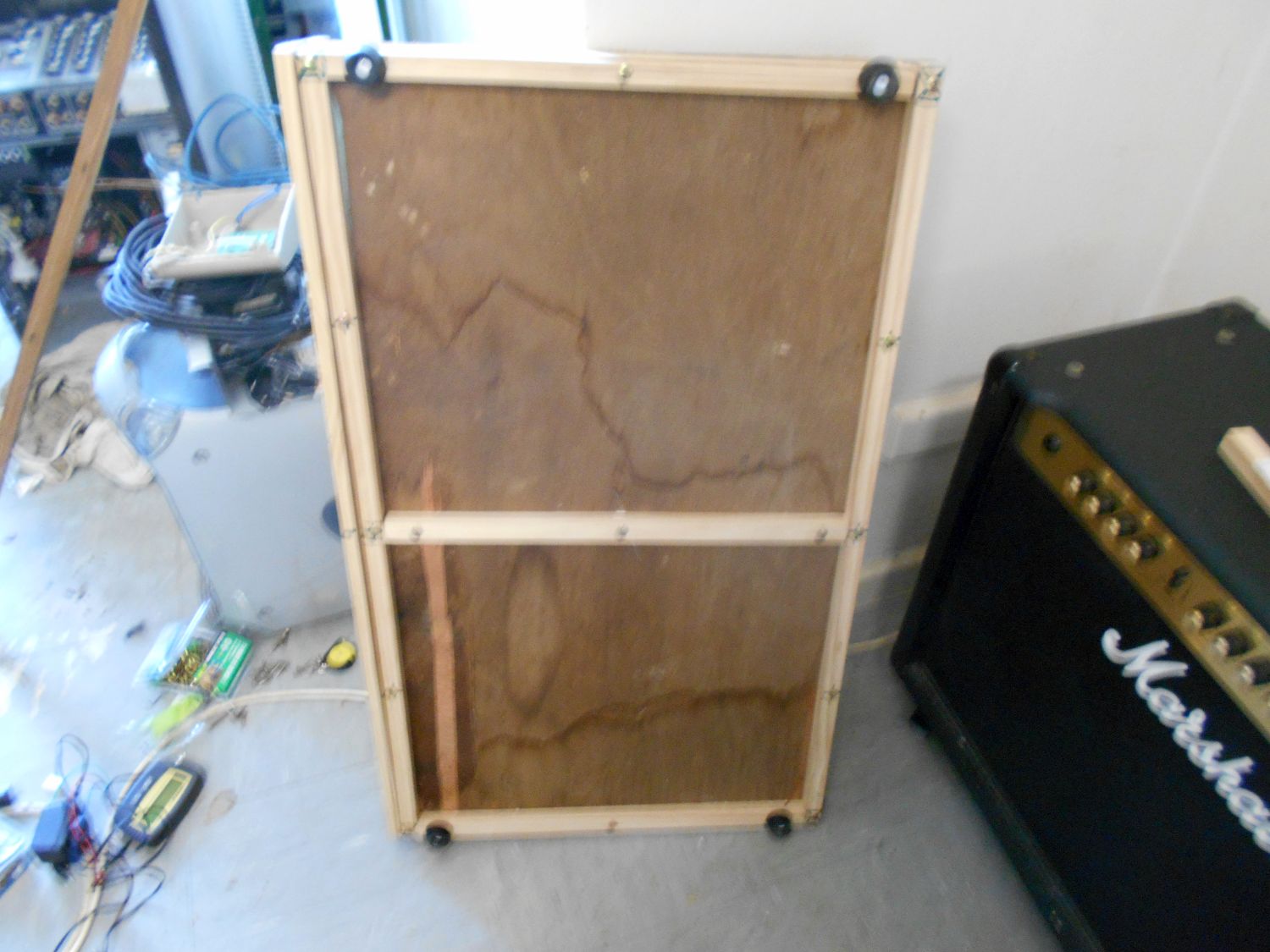

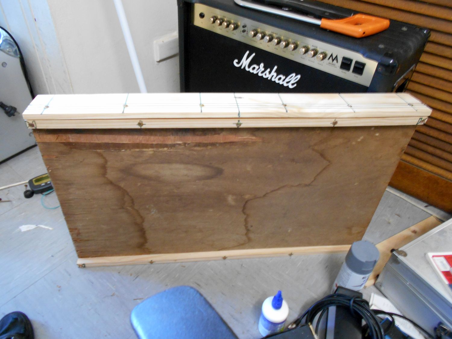

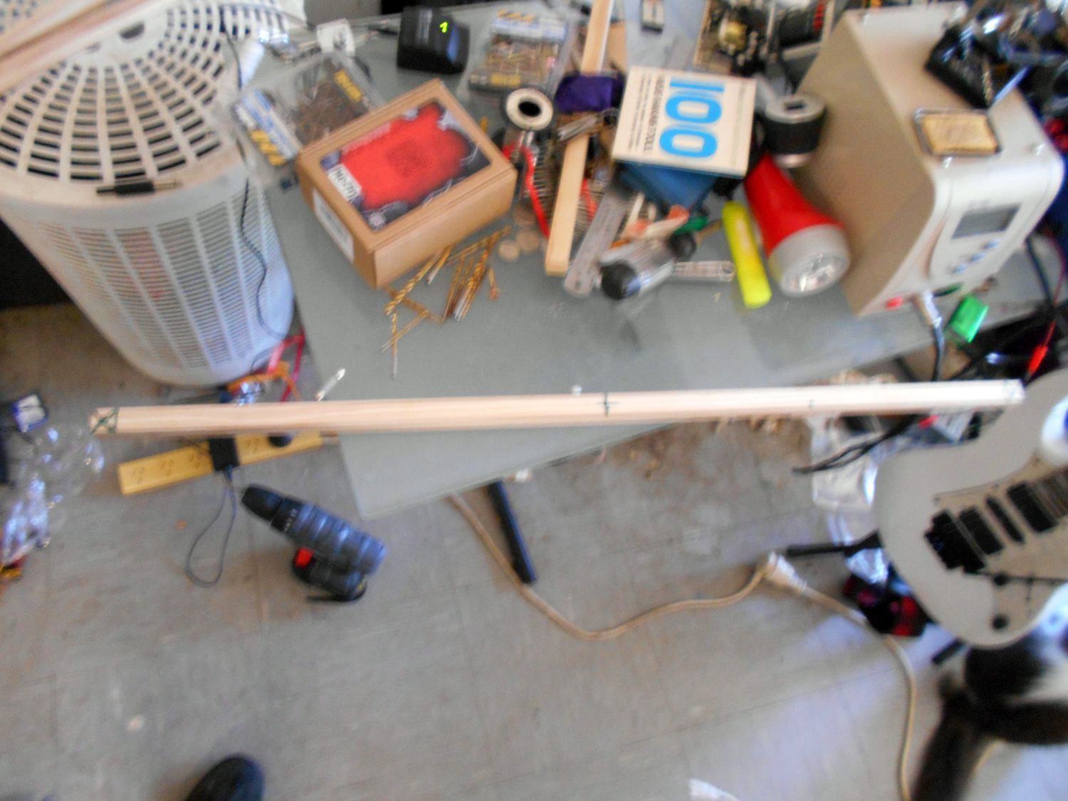

The pedal board I'm going to be making is based on a design I saw in one of my magazines, I had to modify the design a bit so I could use the materials I had to work with, a mate gave me a piece of 13mm plywood that was 800mm by 450mm in size, and I bought some 13mm square timber, and some 90mm by 12mm timber from my local big green shed together with a couple of charcoal coloured carpet tiles, I'll explain what the carpet tiles are for shortly.
The 13mm square timber is to raise the 800mm by 450mm board off the floor a bit to allow some clearance in case I need to run some signal leads underneath the board, the Carpet Tiles are so that I can stick the pedals in place with Velcro strips, the good thing about Velcro is that you can easily re-position the pedals anywhere you like on the board, some guitarists like to permanently attach the pedals to the board.
