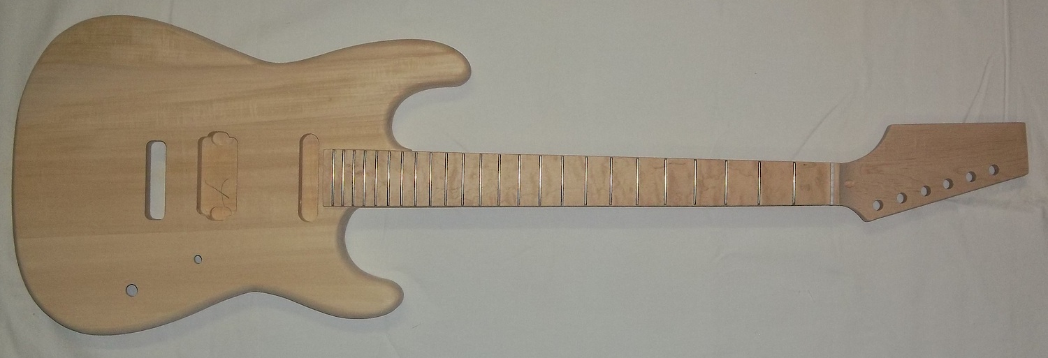

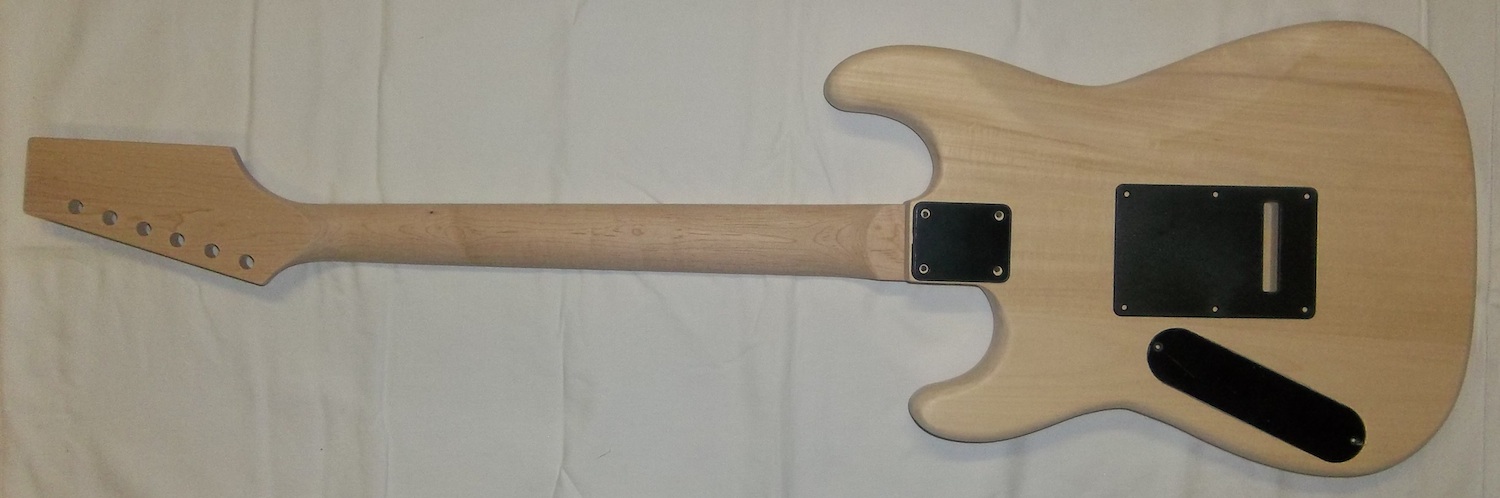

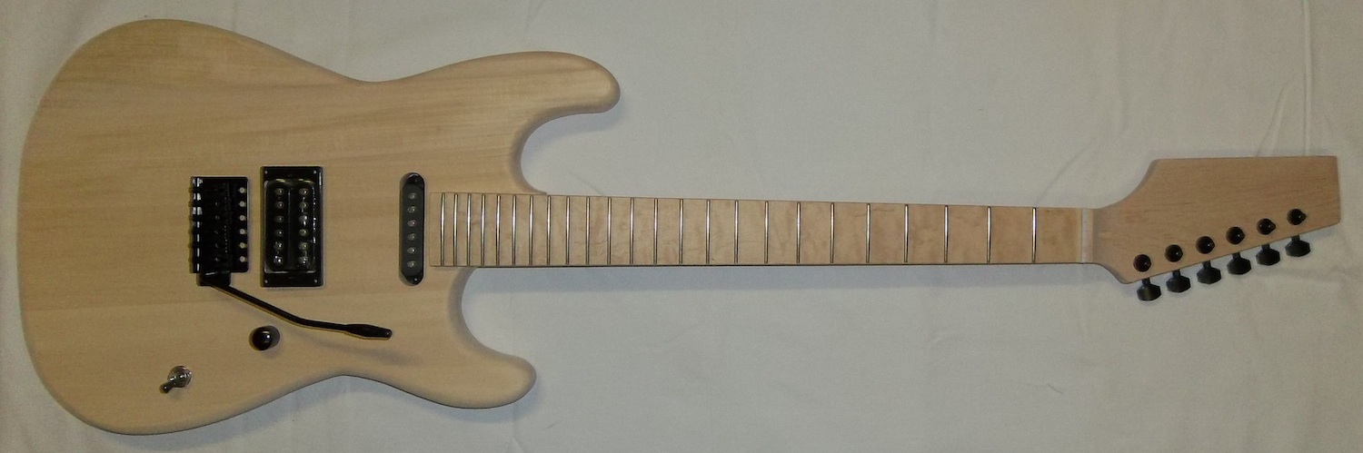

Following on from Nicko's thread, here's the next variant of the community kit… let's be creative and call it #2. Thank you Adam and the team for giving me the opportunity to build it.
- Basswood body
- Maple fretboard
- 24 frets
- Reverse headstock
- Side dots only
- Humbucker/Single Coil pickup configuration
- Volume & 3-way toggle switch
- Black hardware
It looks kinda nice…
Attachment 13305
Attachment 13306
Attachment 13307
Attachment 13308

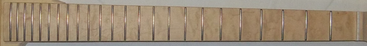

I love the unsullied 24 fret maple goodness.

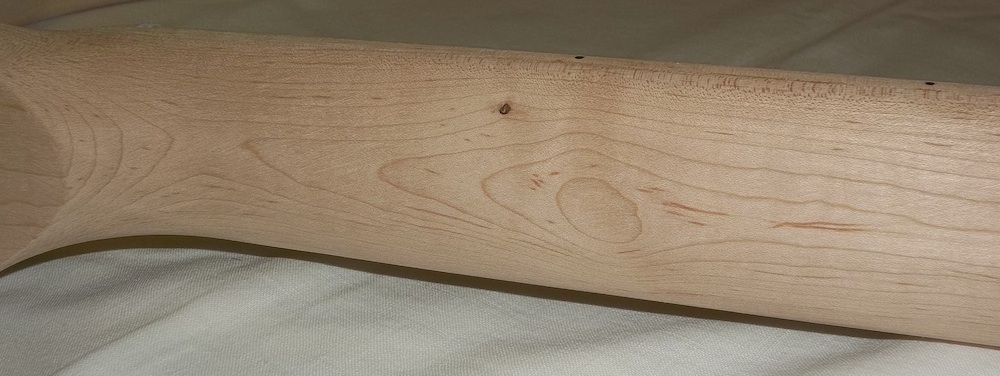

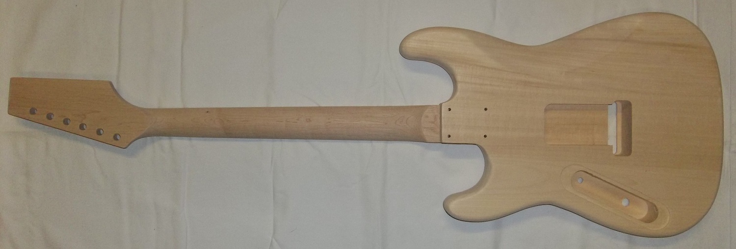

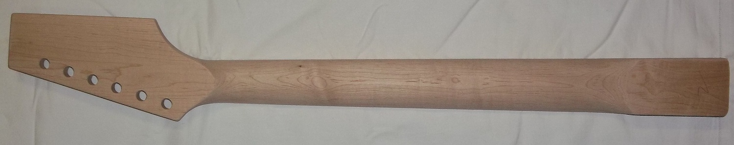

The grain on the back of the neck is nice, but does have one little gnarly knot spot. It'll probably almost disappear by the time it's sanded.

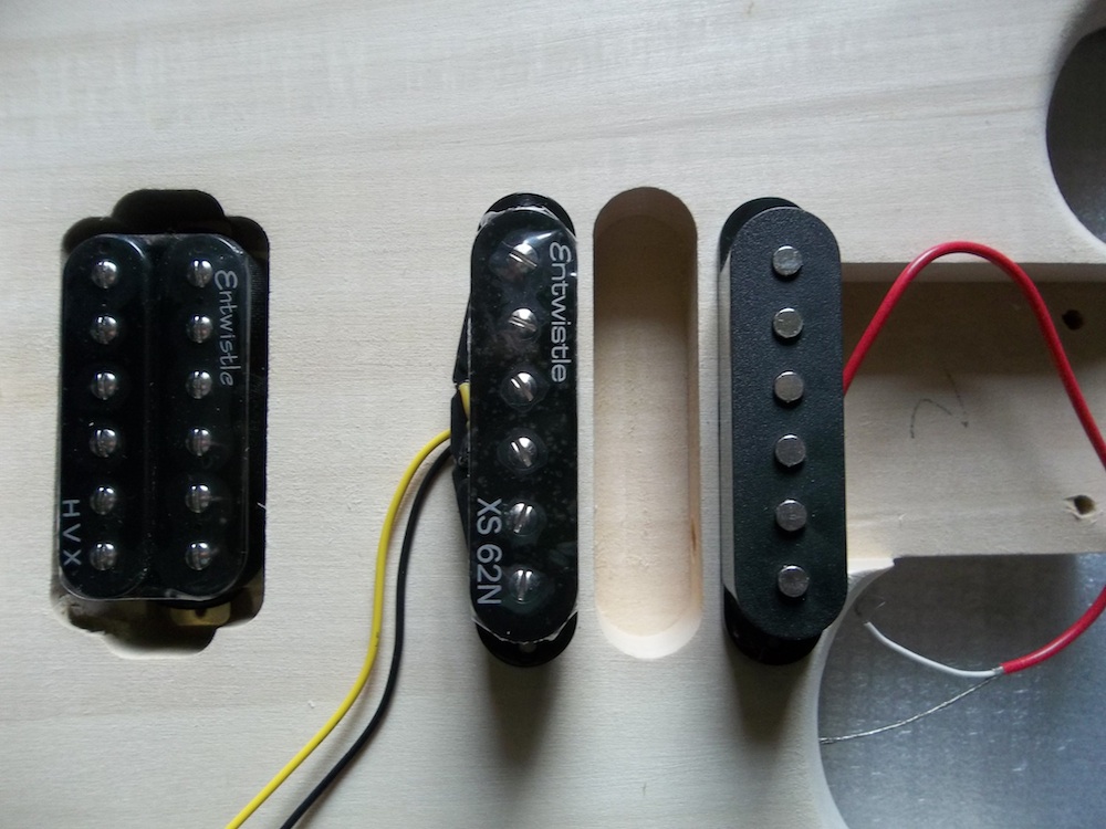

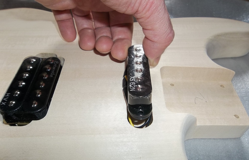

I've got a nice set of three Entwistle pups tucked away for a future build, but for the good of the 'community kit' I'm going to use two of them here: HVX bridge and a middle XS62N for the neck (as it's RWRP).
Attachment 13312

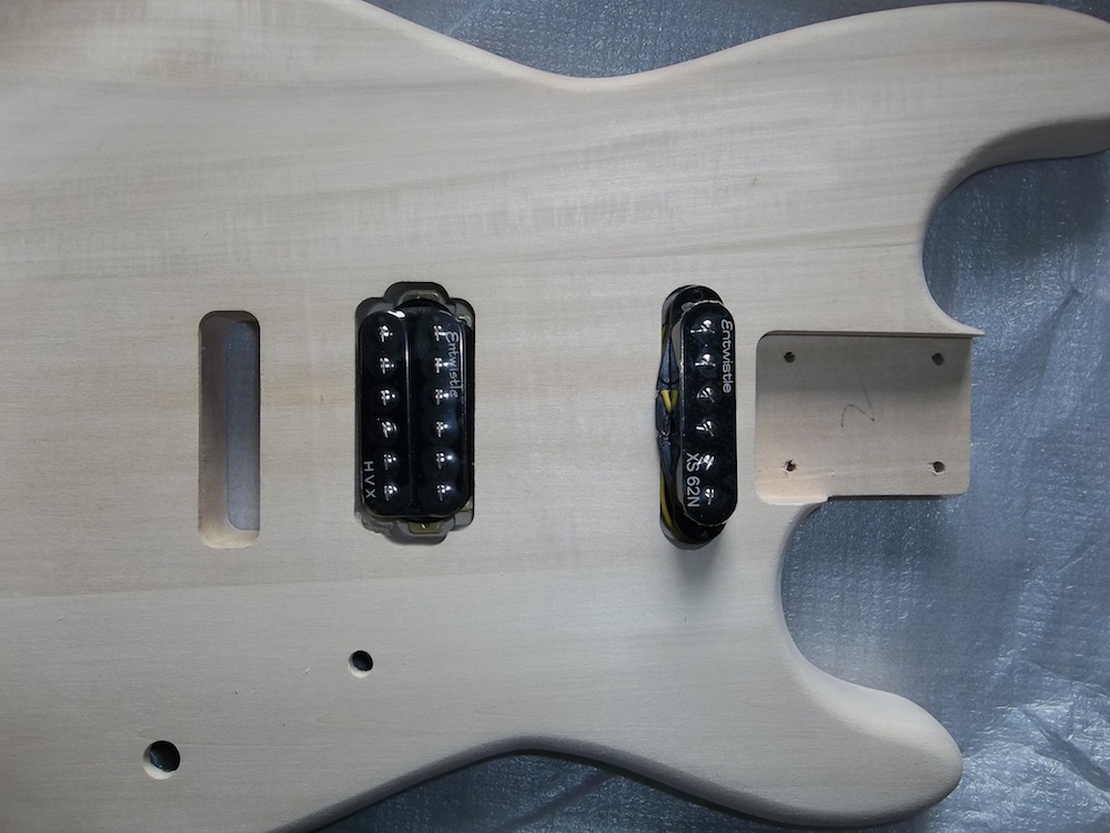

The only fly in the ointment (at the moment) is that the stock neck pickup has flush sides which fits nicely into the narrow rout. But, the Entwistle has the typical flanged base of most singles which means it won't fit… yet.
Attachment 13313
Attachment 13314
I *think* I'll be able to add a slight under-cut to the back side of the rout which should allow the Entwistle manoeuvred in without the cut being really visible if at all. And yep, pups will be direct mount with no rings or pickguard.

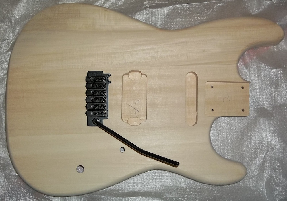

mmmm... that sweet new bridge smell:
Attachment 13376
Wilkinson/Gotoh VS-100N
(so black it's really tough to photograph)
kit looks great Weirdy, hope you can finish this build before the tele build !
Bridge and Entwistles look good
That is a sweet looking bridge.
