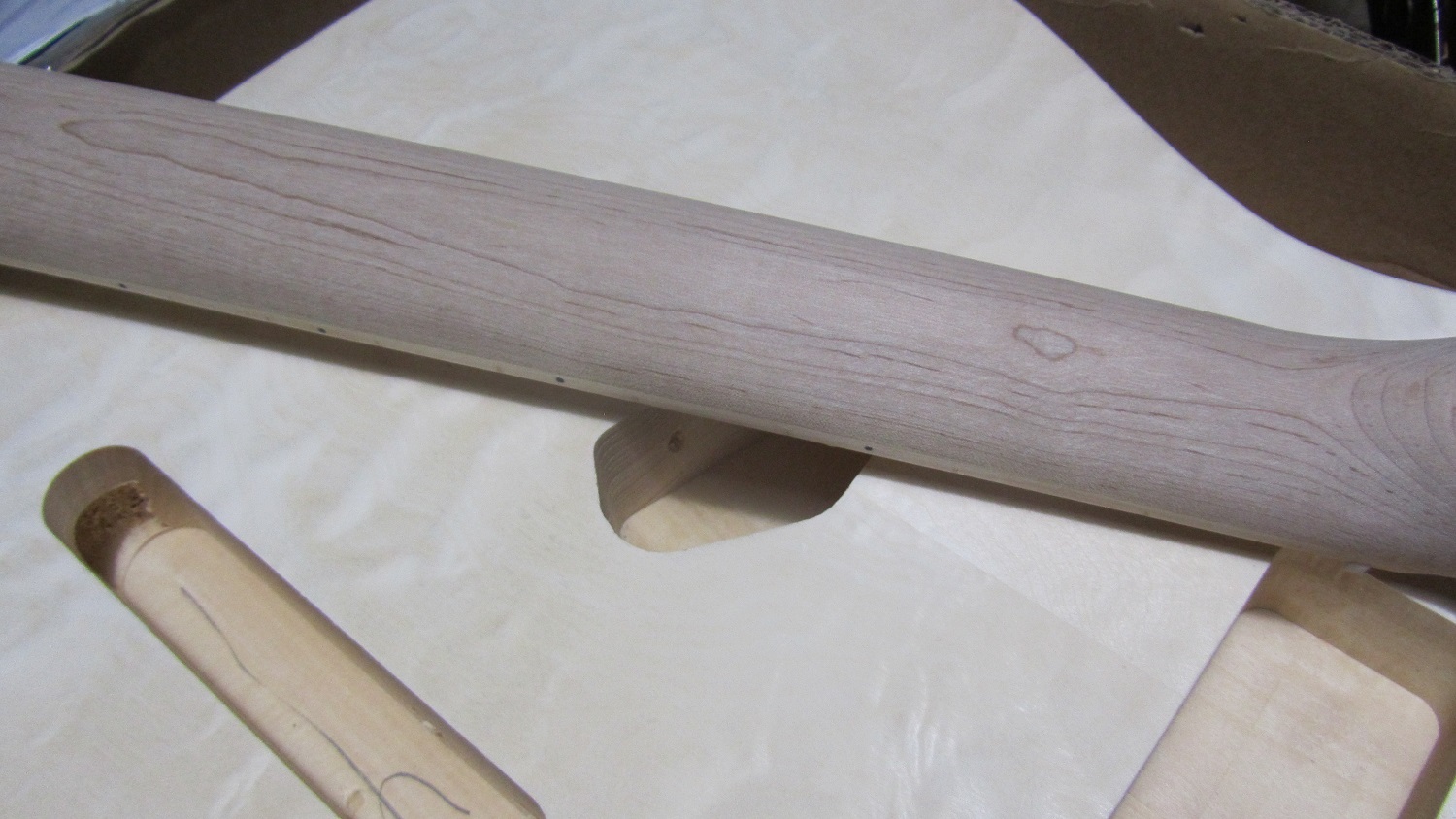

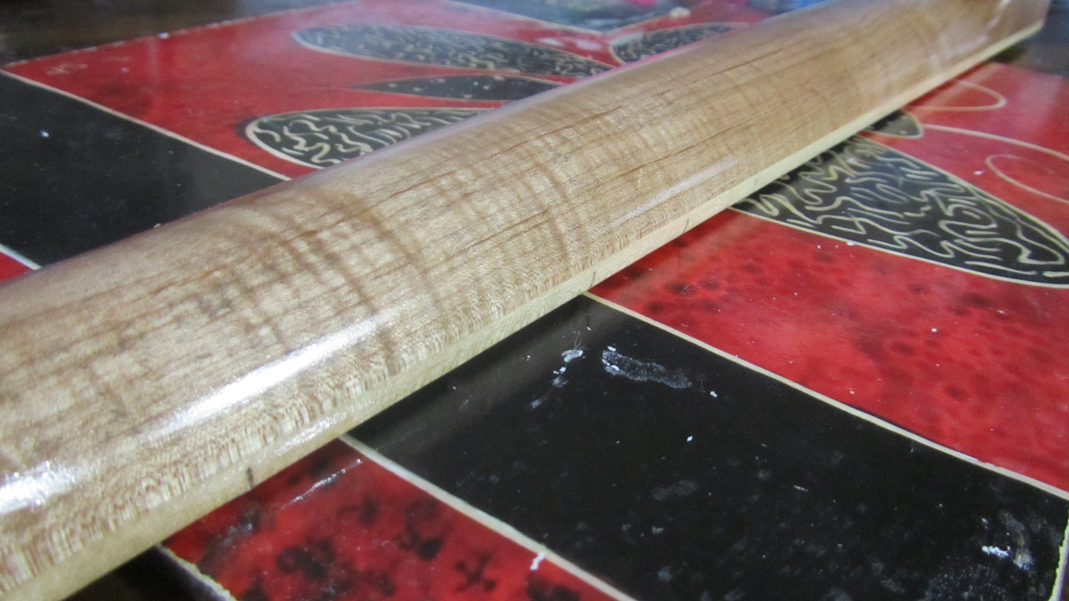

Hi Dan, I use Nugget Boot Polish I my Neck Build...Found it on a wood working site....I like that different things pop up...The nasty chemicals are no good if your going to sit there playing it for years whilst it leaks into your lungs..i attached my neck photo before/ after to encourage different dyes...With that said I used DingoTone on the body and its BRILLANT....Used it indoors, and I have a young son..Attachment 13227Attachment 13228
