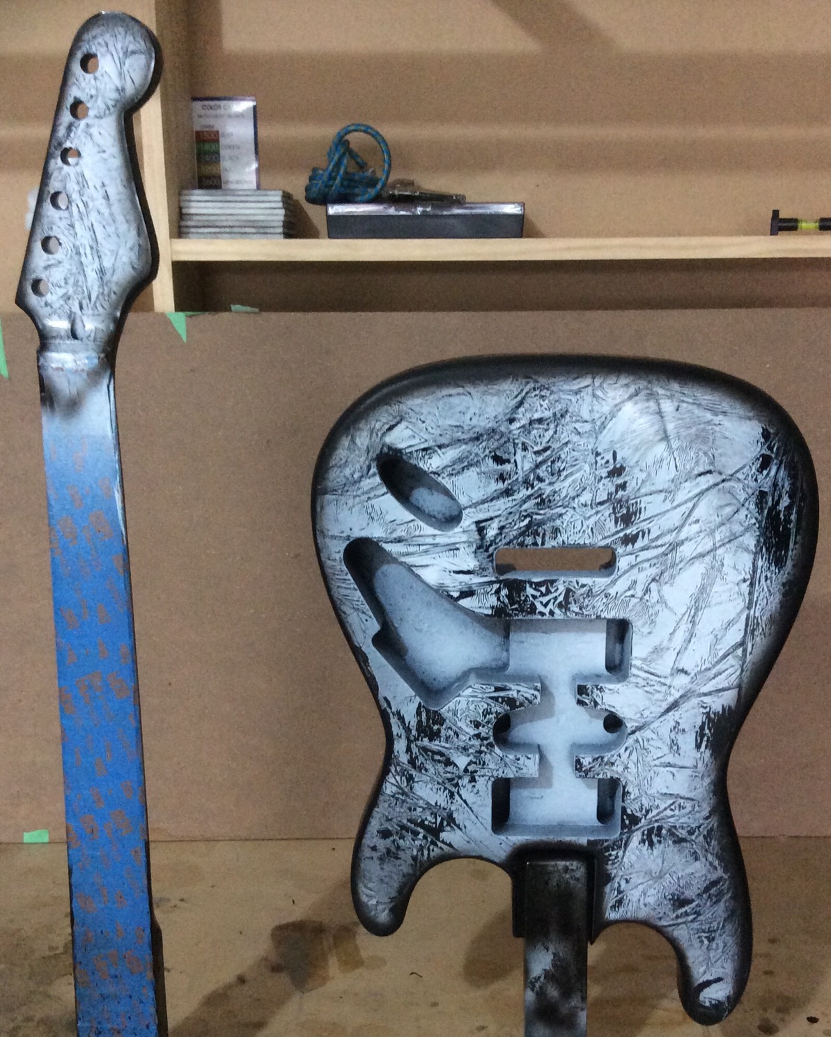

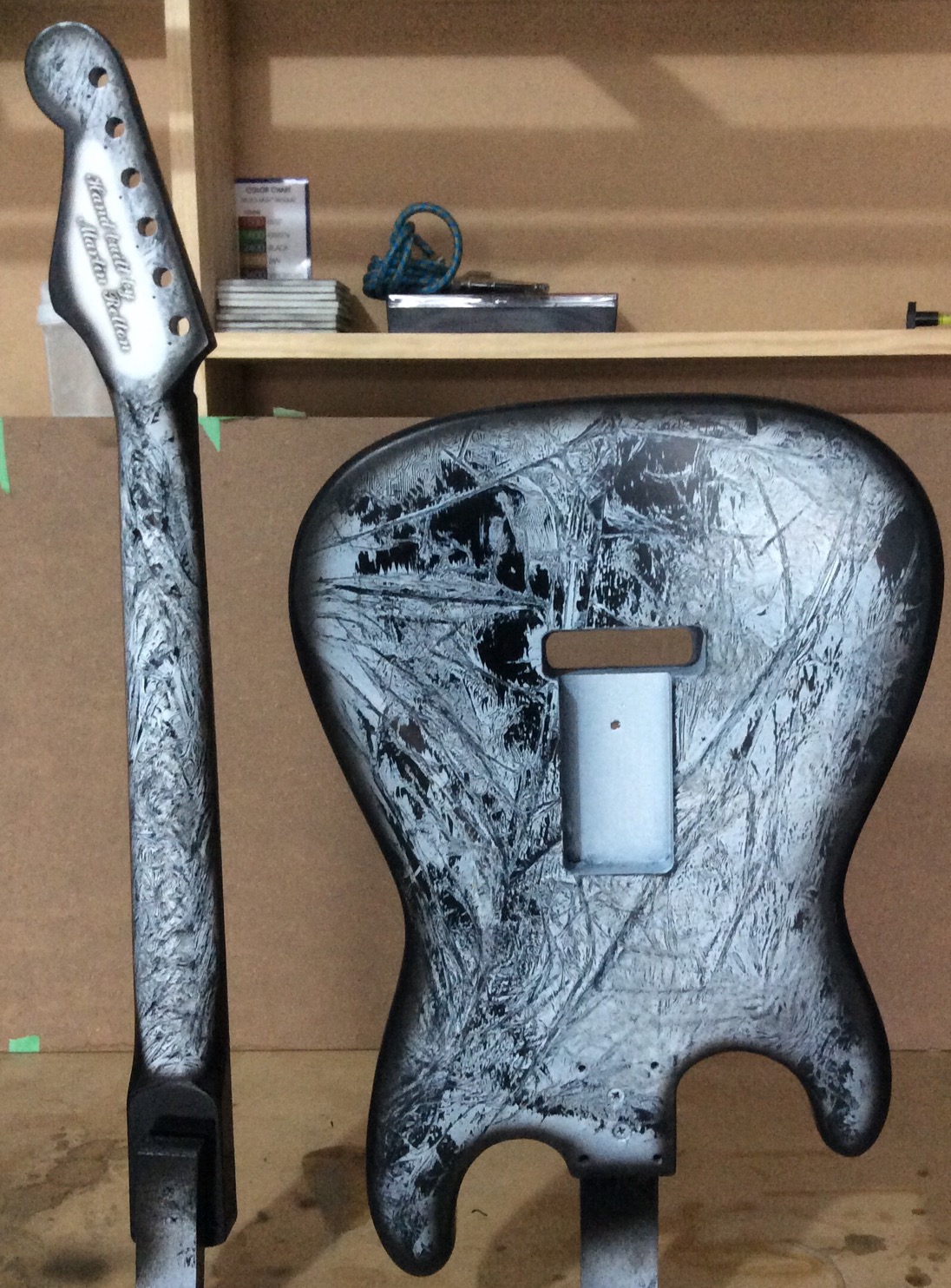

This part worried me the most...

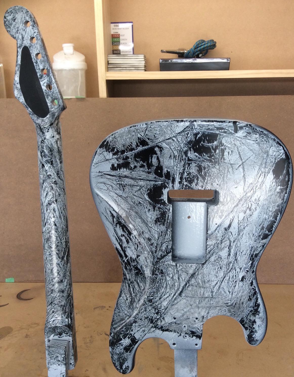

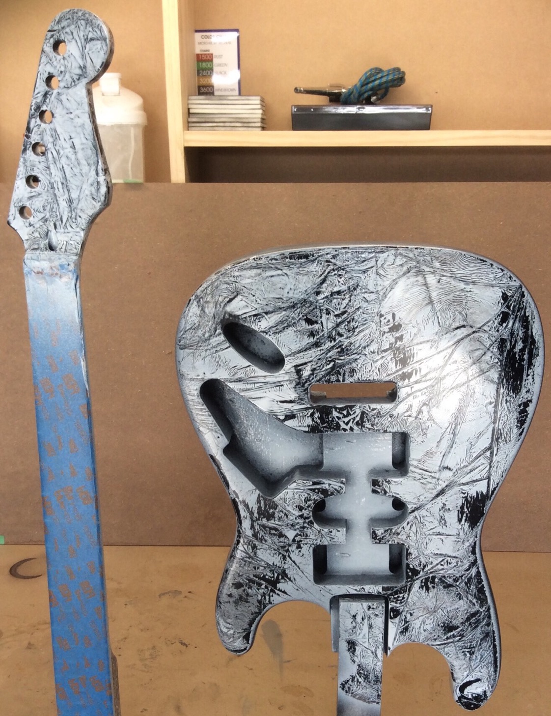

Laying down a white basecoat over the black and covering with cling wrap while wet. Took two attempts. First attempt I took too long to take off the wrap and it looked rubbish!
Had to wash off all the wet white paint, dry sand back to black, respiratory black and start again.
Second attempt with thinned down paint and a quick on and off with the wrap and things looked better
Attachment 12916
Attachment 12917

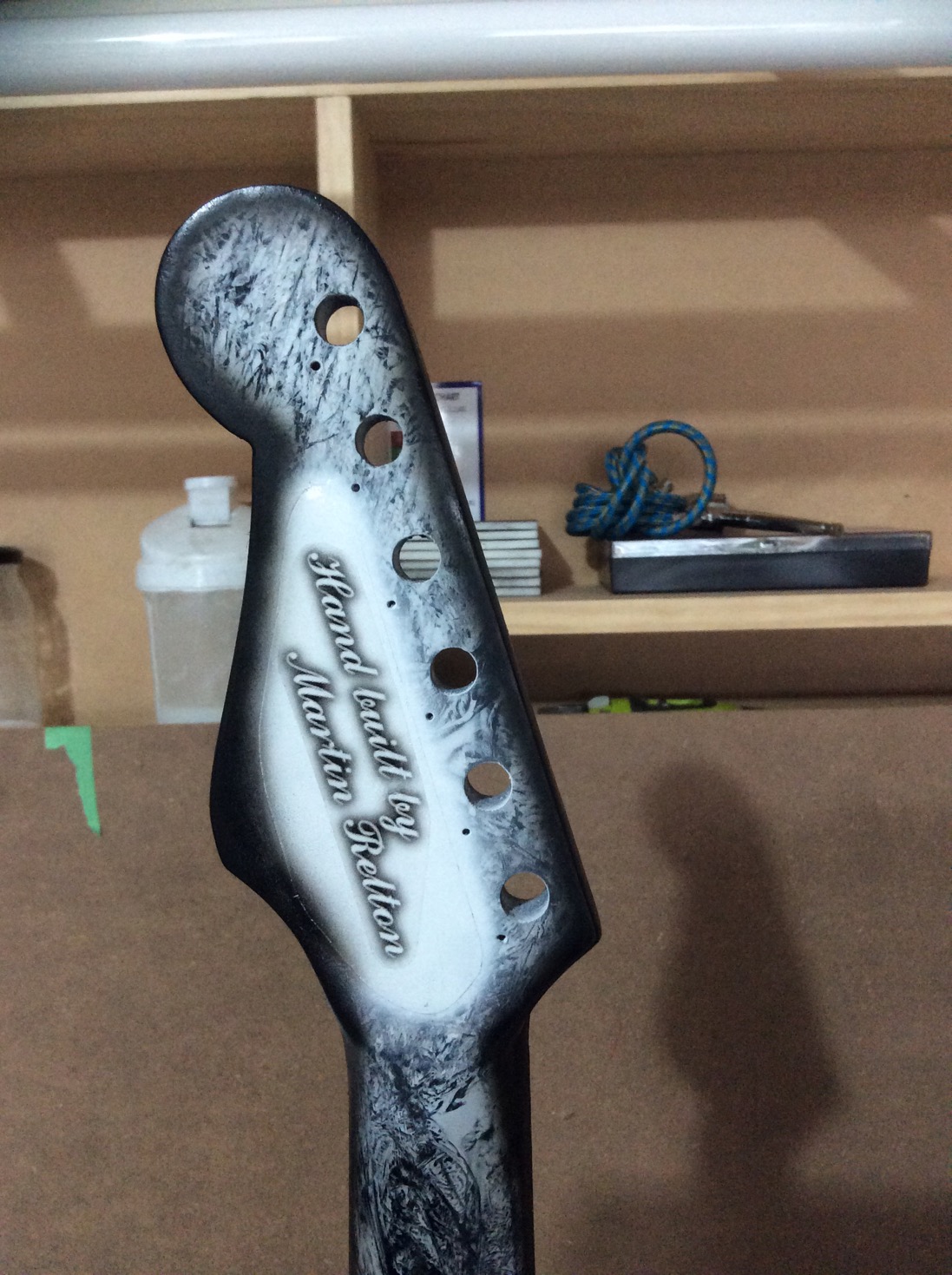

Sunburst and logo added, ready for the red candy coat.......my next worry bead!

Thats a cool effect Mareton, where did you get the idea for that?
Andy, I watched a couple of guys in the US on YouTube painting a motorbike fairing and the end result looked pretty good.
Thought it would look cool on a guitar.
https://youtu.be/67u3iA145_Q
this is going to look great!
That looks pretty cool Marelton. I'm a bit over the "swirl" effect but this is something a bit different. Love it.
That looks fantastic as it is! Can't wait to see the candy red.
love the effect Marelton looks very cool. Can't wait to see candy red over that should look sweet as
As we say in Afrikaans - Bliksem!
Gotta say that if it was me I'd be tempted to leave it in that colour, I reckon it looks great already.
Can't wait to see how it turns out with the red though!
