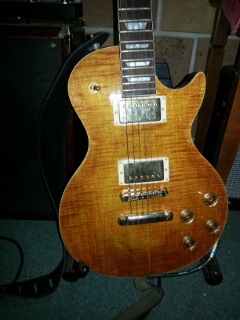

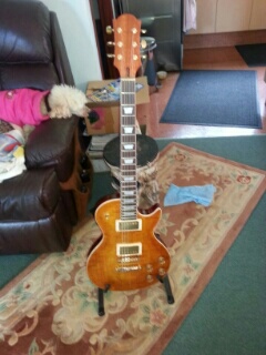

I'll no doubt get the hang of posting photos eventuallyAttachment 11497
Hi Colin, the first LP build looks great, pity the images are so small can't see much detail.
You should be able to post pics up to just under 1MB and maximum resolution of 1500 x 1500.
Good luck with the 2nd LP build
This wasn't a standard build. Tonerider alnico 4 type pups, CTS pots, aftermarket tuners, push/pull neck tone control for "Peter Green" out of phase middle position. I changed the tone caps for .10 instead of .022, so the full range of the tone controls were useful (great woman tone).
And importantly, I took off the plastic nut. It wasn't cut very well. When I got it off I found it was hollow. That can't be good for sustain. I put a brass nut on, had to buy some nut files, but that was fine.
One problem was lack of room for intonation adjustment. I had to reverse the 3 bass saddles and move them all as far forward as they would go to get close. After adjusting the truss rod and action, I was able to get slight excess room for adjustment on only 4 of 6 strings, but the others were close. I actually ordered a bigsby and locking roller nut, as the roller nut has forard and backward adustment at the posts. But I gave it to my son before it arrived.
