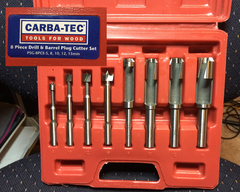

I bought me one of these sets for exactly this reason.
Attachment 9128
nice one Muzza, what are the PBG tuner holes, does a 10mm plug fit ?
