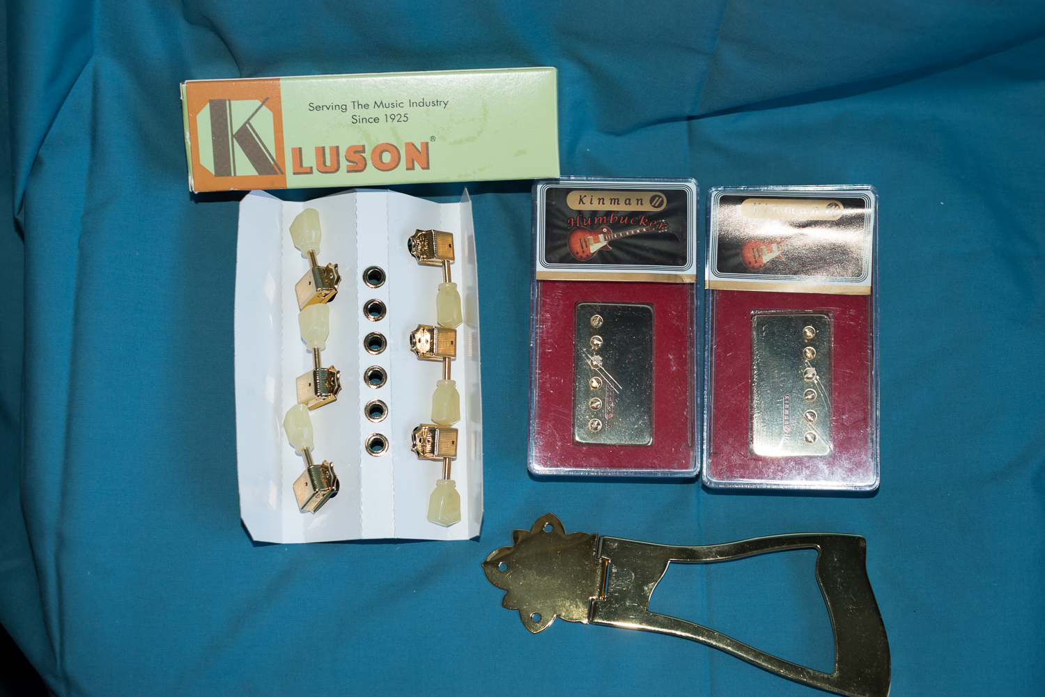

Pickup's are Kinman noiseless Humbuckers, Gold Kluson tuners with pearl knobs, I bought a Gold trapeze tail piece [not too sure about this one, it might get replaced]
All volume/tone pots replaced with 500k Boyle's , same as the Es-1 upgrades, Vintage style Gold volume/tone knobs.

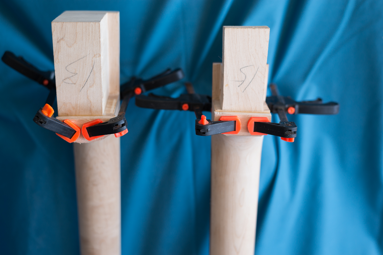

I had a deveil of a time getting the neck flat on the ES-1 kit, pretty easy in comparison on this ES-3's neck, and not much to level...so that's good.

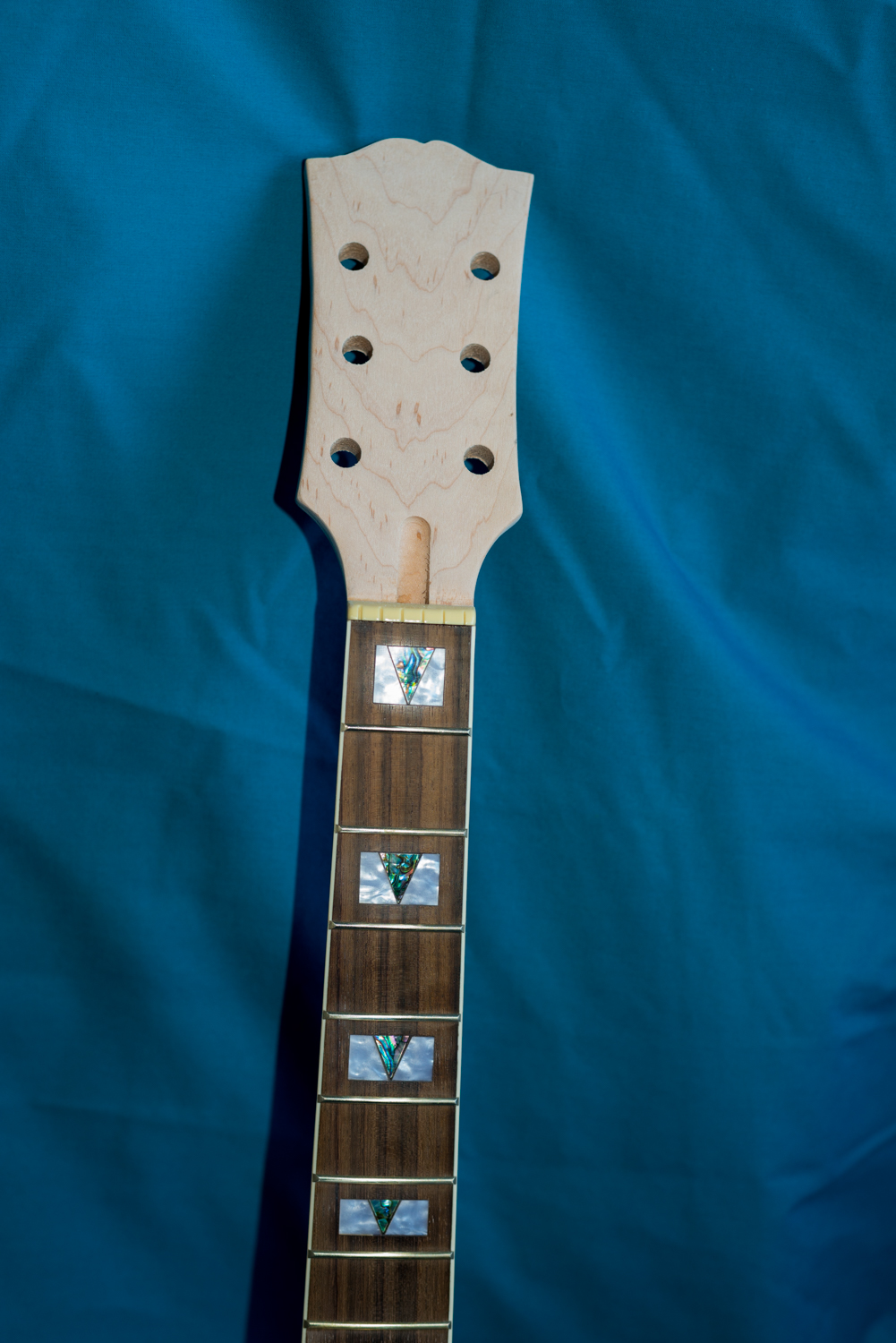

I went for a early 50's Gibson headstock look...still needs some work as it's not quite symmetrical.....and I might veneer it.

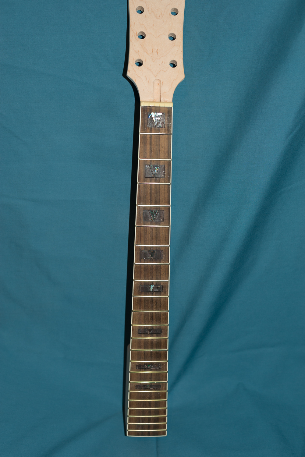

Attachment 8509

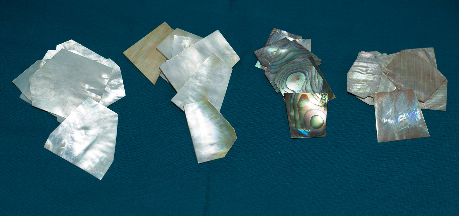

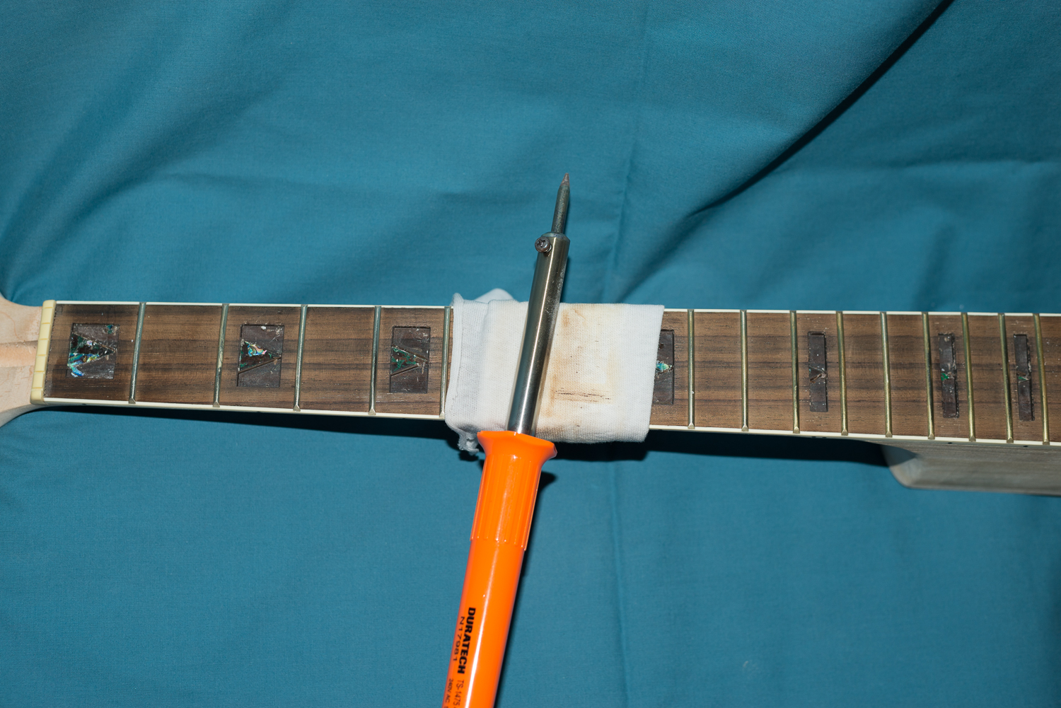

I bought a Micro Mesh sandpaper kit a while back, as I thought I'd try it on the ES-3's inlays....well they really POP NOW!... to such an extent that after staring at this neck for a few weeks, I don't think the inlays are going to suit the rest of the build, they are just going to clash.....so I'm going to take them out and replace them with real mother of pearl
I asked a jeweller friend to show me how to etch/engrave MOP, so I bought some tools to do that, and some Indian Ink to shade the etching with.

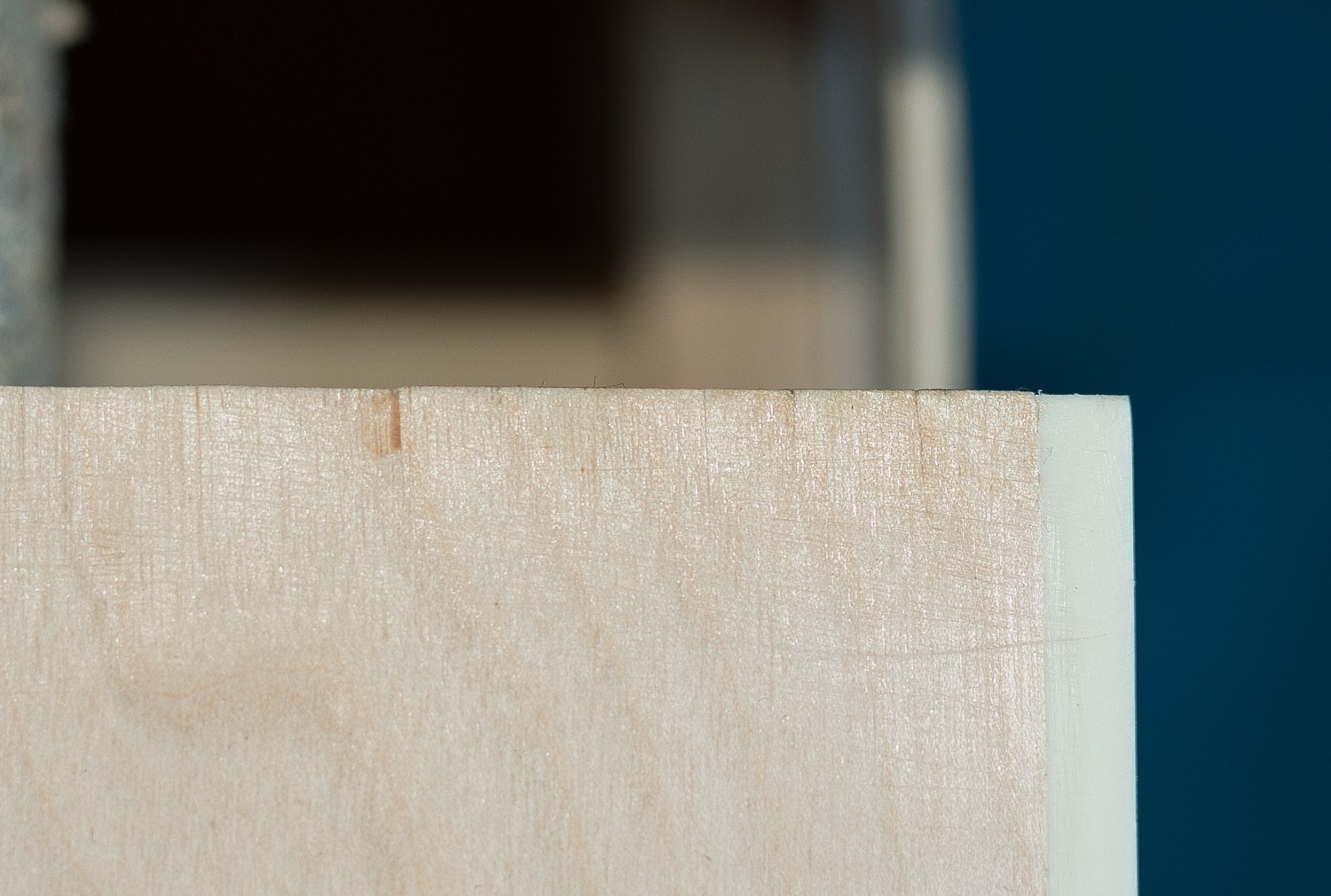

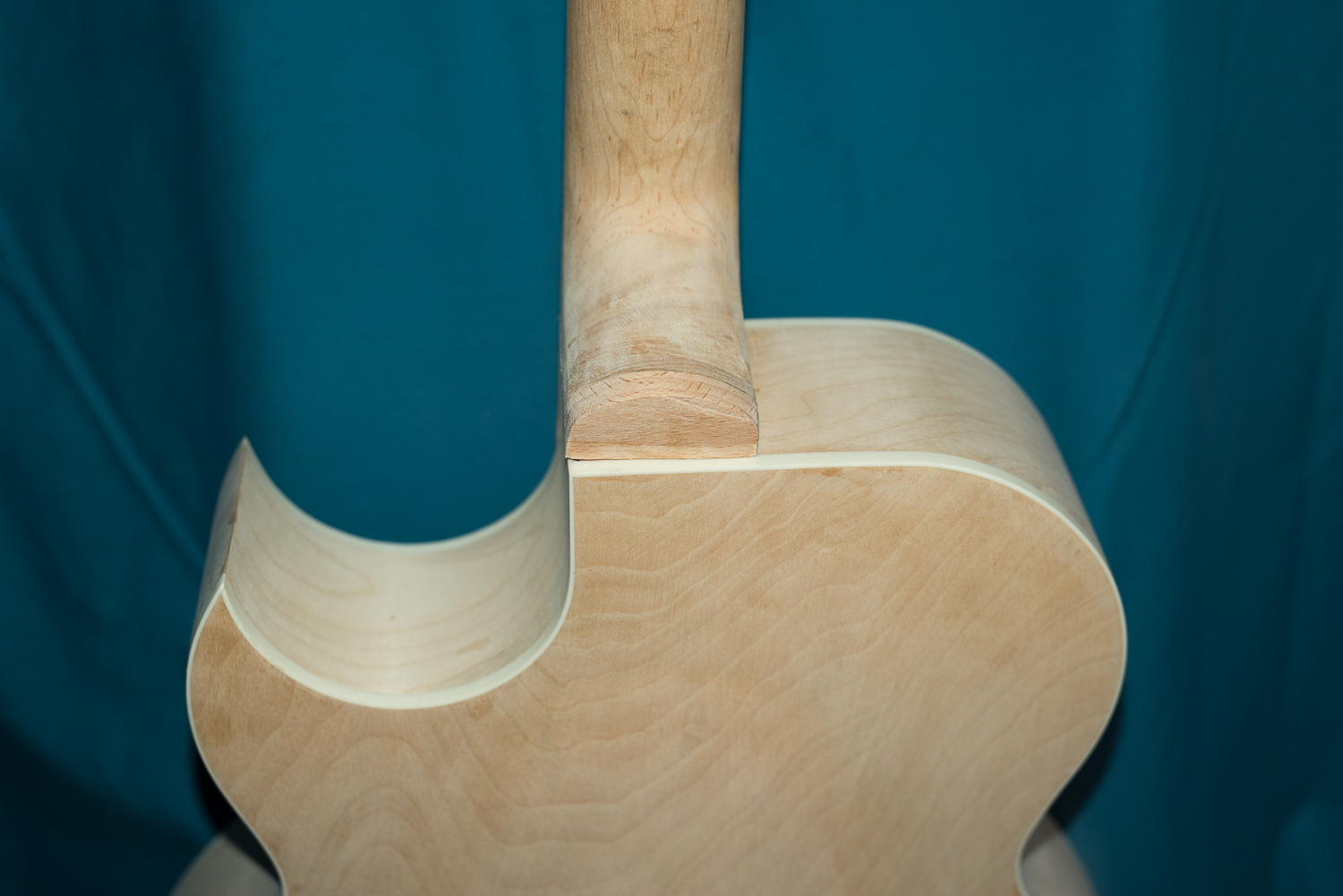

I have had one small problem with the ES-3's body, and that was after I did a test construction when I first got the kit....when removing the neck, small parts of the very top layer of the ply near the neck joint started to lift and split....I got two scalpels and slide one underneath to lift the top layer, and used the other to spread some titebond in the gap hoping it will fix the problem....it has to a extent, I'm just wondering how visible this small cracks are going to be under a Blonde shellac finish [photo of problem cracks]
Attachment 8510
On the unfinished wood it is quite noticeable ...not sure how well it shows up in the photo.
Would using some neutral or white wood filler be recommended, or shouldn't I bother and just live with it ...I'd prefer to get it as best I can, as it is right where I would be staring down at the neck when playing.
