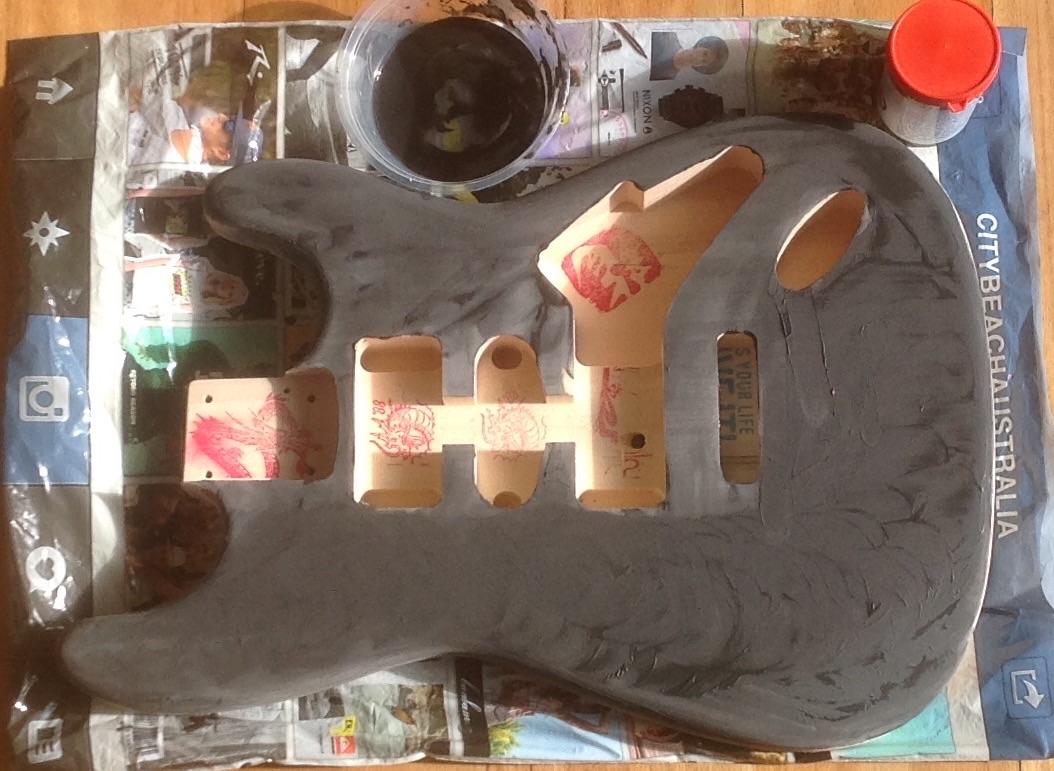

Attachment 7129getting started. Wanting to do this one in a mat black. Any tips?
Attachment 7130filled the pores time to start sanding.

The only tip I have is matte black is very tricky to get right. The final coat must be perfect, because if you have to sand it the finish changes, and you can't polish out any small errors or it isn't matte any more.
You can use a flat or matte black with a matte clear, or just matte black
That said, when it's done right, it looks awesome
nice start Tadeo, looks like ebony timbermate you used ? what are the red stamps you put in the neck pocket/control cavity ? nice touch !

My dad took me hiking in Japan a few years back and we got these cool hand carved dragon stamps. I've put them in the holes in the JB and thought I'd just keep it up. Thanks for the support. I've 5 guitars a banjo. I'm going to make a ukulele after this one.
