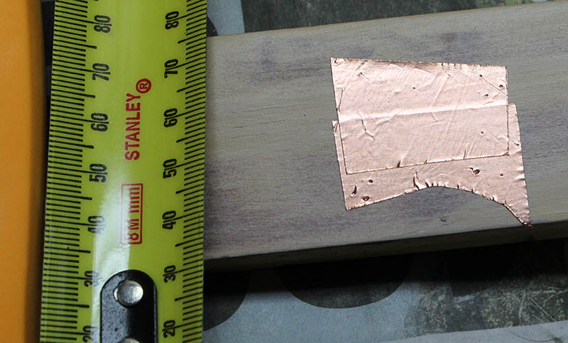

Just mooching around the shed and decided to experiment with something that has been bugging me.
I overlaid two pieces of copper tape:
Attachment 6133
As is done in most guitar construction efforts.
Now, a capacitor is essentially two pieces of metal overlapping each other separated by a dielectric material.
So two pieces of tape separated by the glue backing, does this equal a capacitor? In other word is the overlapping of tape inserting capacitance into our guitar circuitry.
A little surprisingly, the answer is Yes.
I simply measured the capacitance between the two pieces of copper.
In the randomly selected but probably indicative sizes used in my experiment it resulted in almost 0.4 nF (Nano-Farads).
A small amount, for sure, but in an AC circuit the reactance is also of concern. Reactance is the resistance presented by a capacitive circuit - as frequency decreases reactance increases, so if our signal is travelling across the shield, and as the ground component of the AC it can, will this affect our bottom end response?
I don't really know enough about the response side of things to say, and it would be difficult to objectively test.
So I'll throw it over to some of the more experienced wire fiddlers to shoot down my theorem - as the scientific method would ask me to do...
Oh, btw, the way the simple way to overcome this reactance issue would be to make a solder bridge across the joins, thus the path is no longer capacitive.
