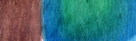

		Hi Wokkaboy,
I'm doing  a LP 1 Kit and I'm using U-Beaut water dyes this is my colour palette test.
Attachment 3785
The brown is for the back of the neck the sides and the back of body while the top and front of the head stock is green with a blue burst. I'll add this to a build diary.
