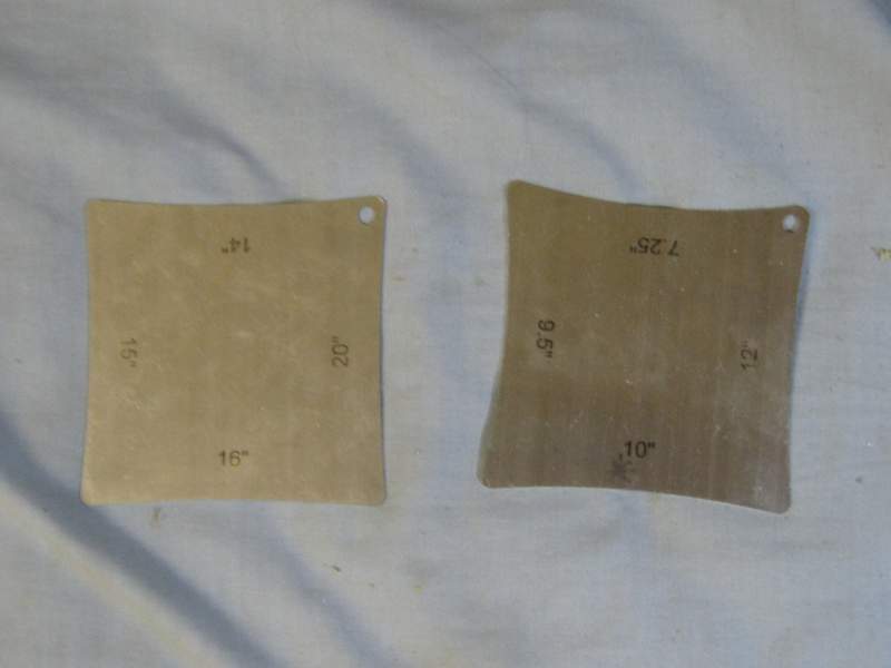

Stewmac.com stock these handy Fretboard gauges, I've found them useful for two purposes, determining the Fretboard Radius of necks (each side is ground to a different Radius), and also for setting the individual string heights on a guitar (once you have the two E-String heights set, the rest is a breeze):Attachment 1271
