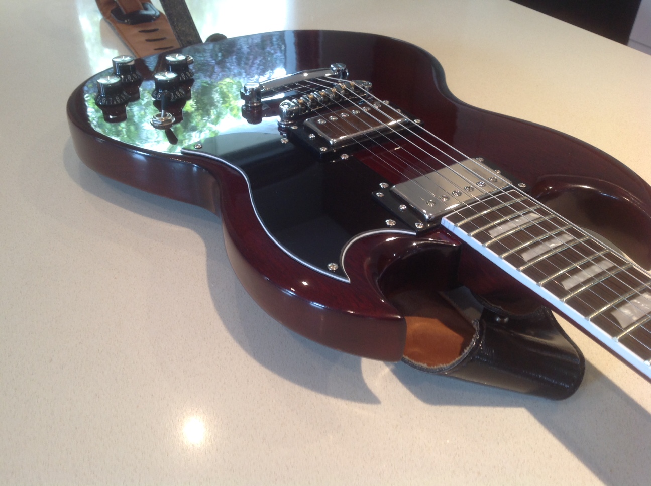

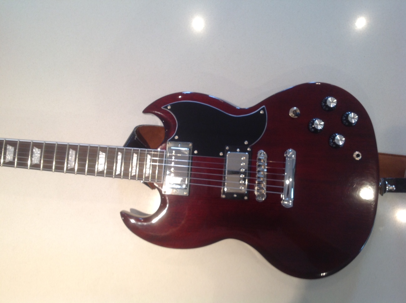

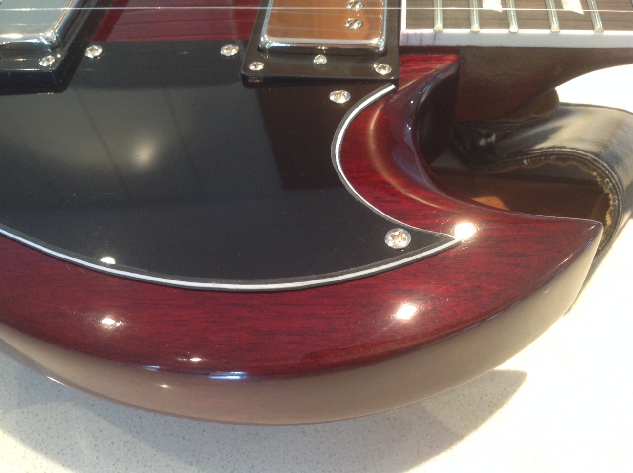

3 Attachment(s)
the now renamed AG kit, custom ordered with a block inlay fretboard, all mahogany tonerider ac2 pickups, bone nut. Feast Watson mahogany meths stain, Cabots poly clear spray pack gloss
Attachment 28038
Attachment 28039
Attachment 28040
Hi Andyxlh
Did you thin that stain when you applied, how did you get such an even finish?
That is exactly what an SG should look like. Beautiful!
