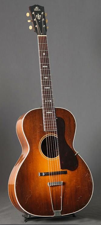

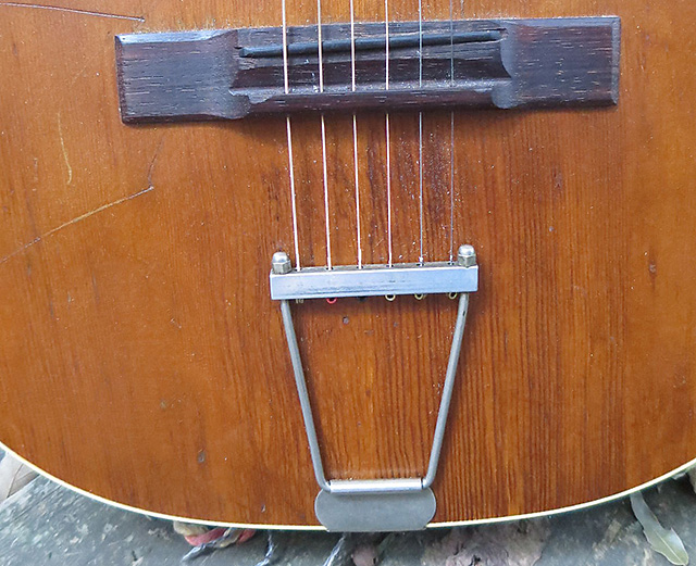

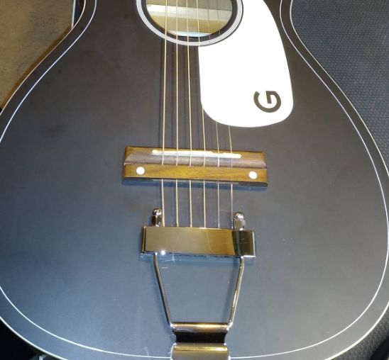

That said, given the level of damage, I don't think the top will ever be strong enough to use a tail-pin bridge again. What you might be able to do is use a trapeze tailpiece:
Attachment 46185 Attachment 46186 Attachment 46187
It would be nice to do it as in the first pic, but the break angle may not be steep enough, which is why the two other pictures have a bar behind the saddle to improve the angle. A bar of some kind would also cover the holes for the string pins. You might need to put some felt or rubber feet under the bar on the trapeze to keep it from rattling.
String-pin bridges put a lot of upward and toward-the-neck pressure on the bridge. They have to rely on really good bracing to keep the bridge from pulling itself off. Trapeze-bridge setups put downward pressure on the bridge that helps to hold it in place, which is, I imagine, why most stringed instruments use them...including many early acoustic steel-string guitars.
