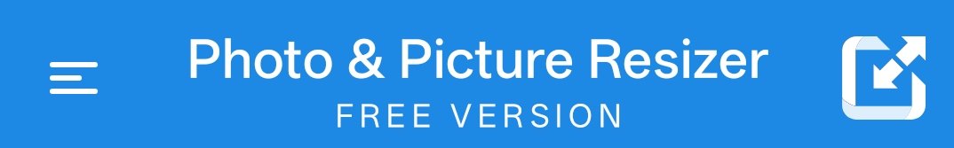

If I need to change the size or type of file, or crop the image, I use Irfanview on computer, which is free and open source. On my phone I use this creatively named product...Attachment 45988
