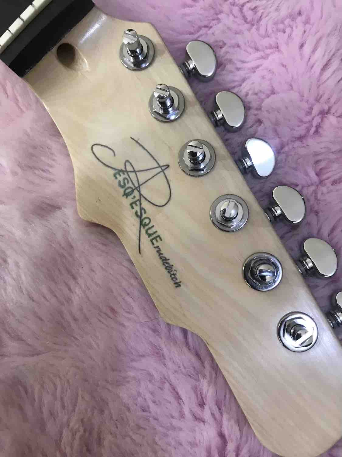

Heres a picture of the finished headstock:
Attachment 45785
It worked pretty well - apart from the ever so slight smudge.
