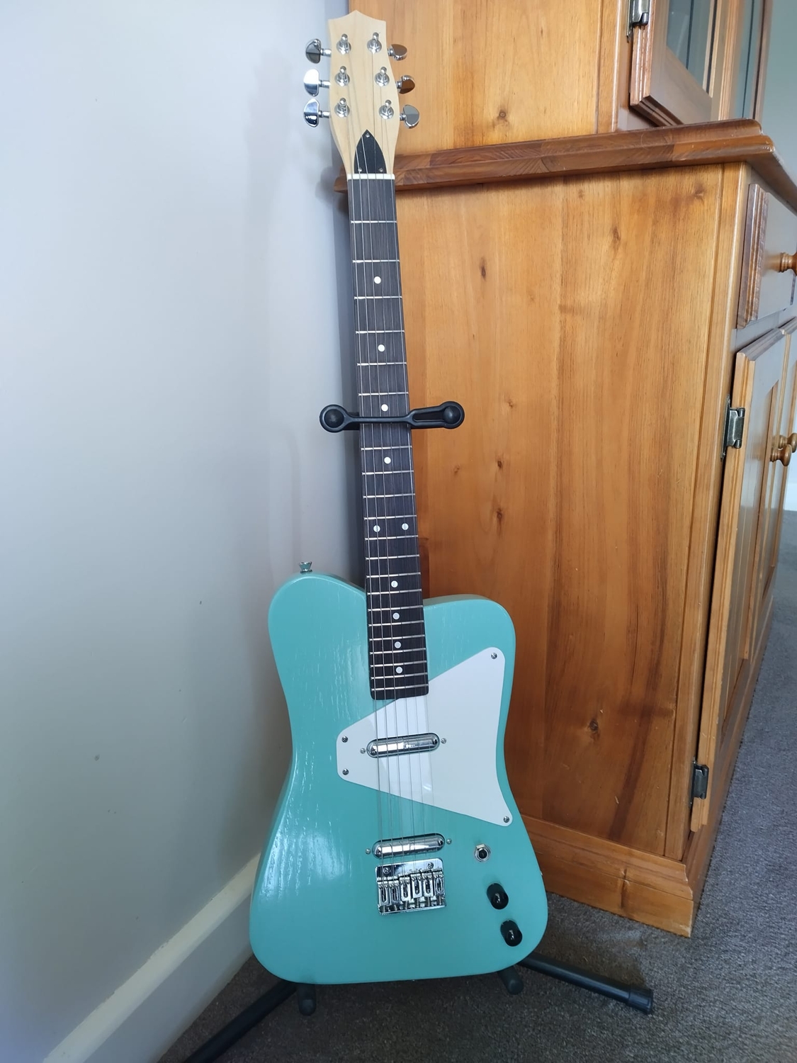

Today I put the finishing touches on my latest project, inspired by the Flintstone guitar - the Danelectro Pro.
I had a piece of 30mm ply left over from other bodies I had made. I printed a template of the Danelectro Pro and found that the body was about 10mm too wide, so I reshaped the body to fit the ply that I had. It was mainly the lower bout where the switches are.
There were a few mistakes made and I may even build another body of the correct shape, but even so, I'm quite happy with the way it turned out.
Hardware was sourced from eBay so it's nothing special. Wilkinson E-Z Lok tuners. Pickguard and back cover are made from 3mm opaque acrylic. The neck was a surprise - smooth fret ends and only a couple that were slightly high. The action is low, the intonation is spot-on and it's a fun little thing to play.
