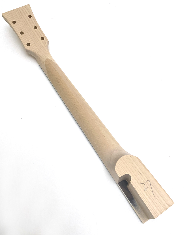

My single-cut kit has a set neck like this:
Attachment 44365
This style of neck has a small "shelf" of fret board which overlies the guitar body on the cut out side.
On mock-up, the fret board sits just slightly above the body (maybe 0.5mm).
When gluing the neck, what, if anything, should I do about this? eg
- not worry about it and do nothing in particular?
- fill the void with glue or filler?
- something else eg make the neck pocket a tad deeper?
