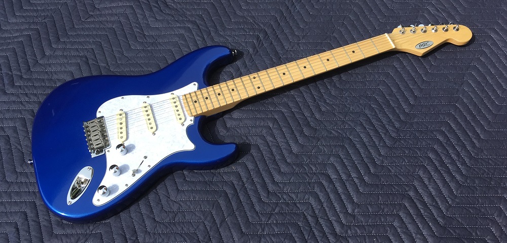

Previously for a glossy sheen, I have applied multiple layers of minwax wipe-on water-based poly, then wet sanded. I finally polished with Meguires mirror glaze ultra cut compound #105 x three times, followed by Meguires mirror glaze ultra finishing polish #205 for three coats. I get a really nice shine with this method for a glossy finish.

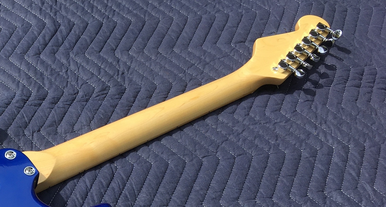

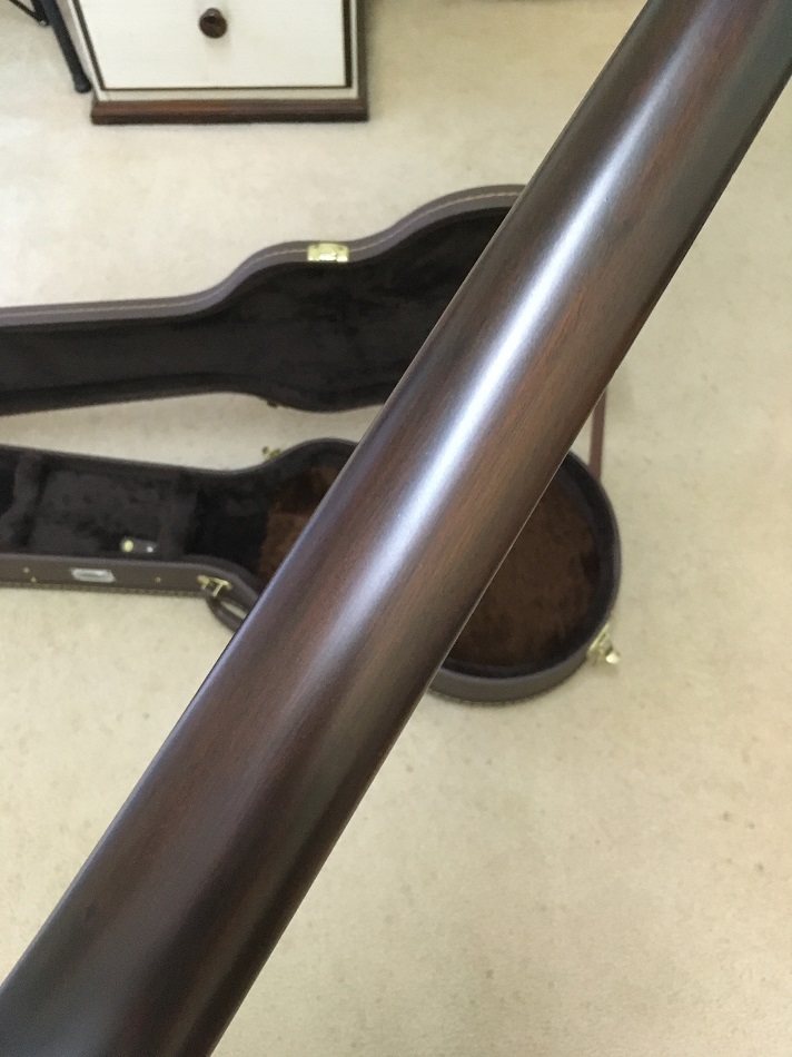

If I am finishing with a satin sheen (say on a neck), I have read you should do multiple layers of gloss poly, and end with the last 2 layers of satin poly.
My question is, do you still wet sand and polish after this, or does that defeat the purpose? Should I wetsand the gloss, then apply the satin poly and leave it?
I know you can just sand gloss back to a satin finish, but I'm nervous about sanding through, or not getting an even texture all over. I'm probably over thinking this, but would love advice on satin finishing. TIA!
