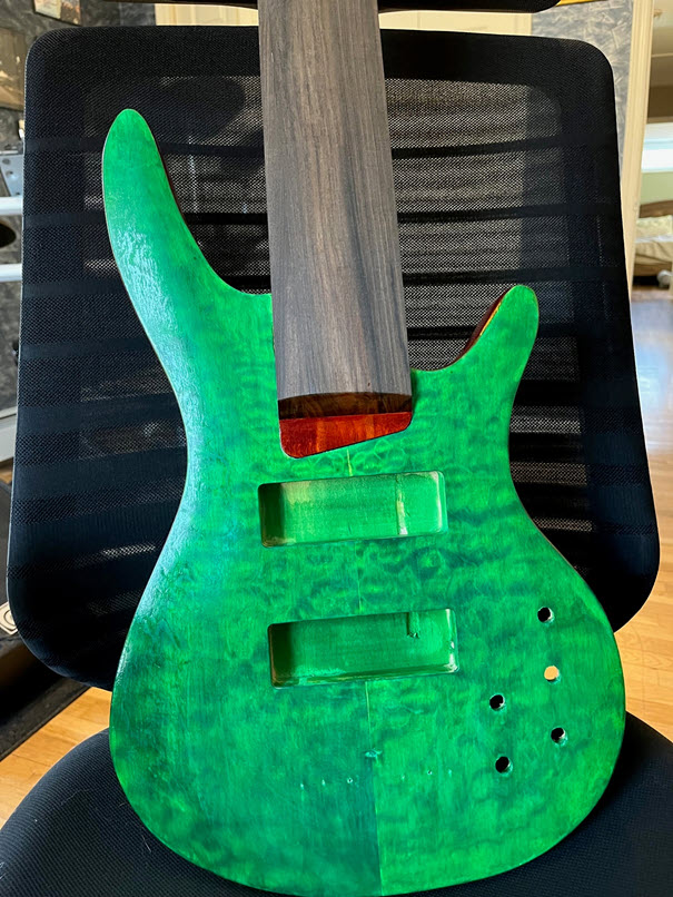

Thank you! I might just do it now, so that I don't have to agonize over it. My biggest concern is the placement of the bridge. The scale length is 34, but I've read that to measure it for sure, you measure from the inside of the nut to the 12th fret, and then double it. Since it's a fretless, and the dot markers are in the middle of the fret rather than the fret itself, I don't know exactly where the 12th fret is. :)
So I'm thinking of just measuring 34 inches from the inside of the nut to the middle position of the saddles and go with that. Hopefully, that will allow me the wiggle room I adjust the saddles for intonation. And I also have to make sure that the bridge is centered so that I don't have the lowest or highest strings flop off the fingerboard. My first kit was a guitar routed for a Floyd Rose, so the poles were pre-drilled. This is all new to me. But I imagine I'm just making it out to be bigger than it is.
