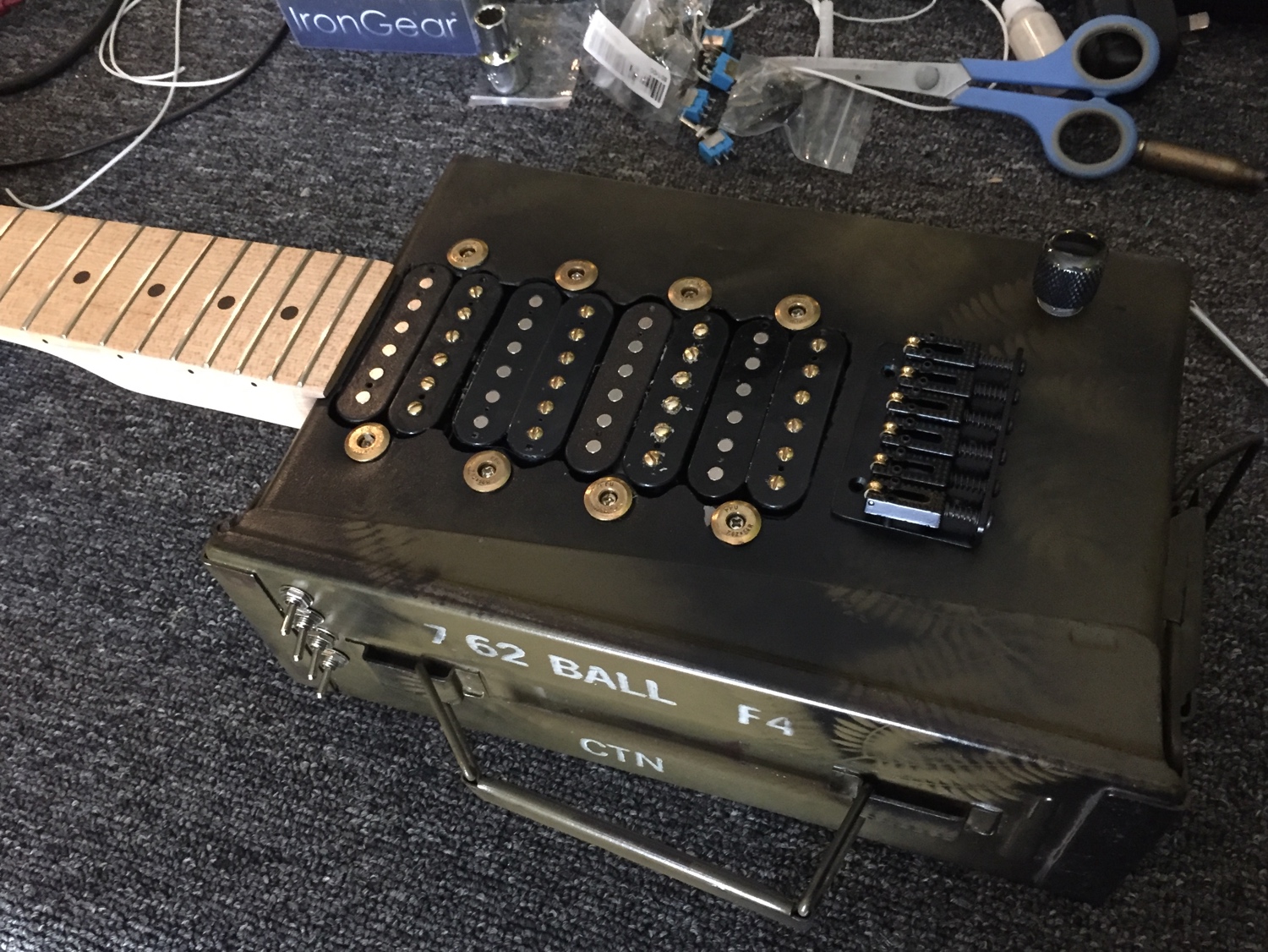

Attachment 43853
Uniquely the design utilises cut down 7.62 x 54R Rifle Casings as the pickup mounting rings.
Note: 7.62 x 54R rounds are what were used by Vasily Zaitsev (Sniper), and as depicted in the Sniper battle, in the 'Enemy at the gates' movie.

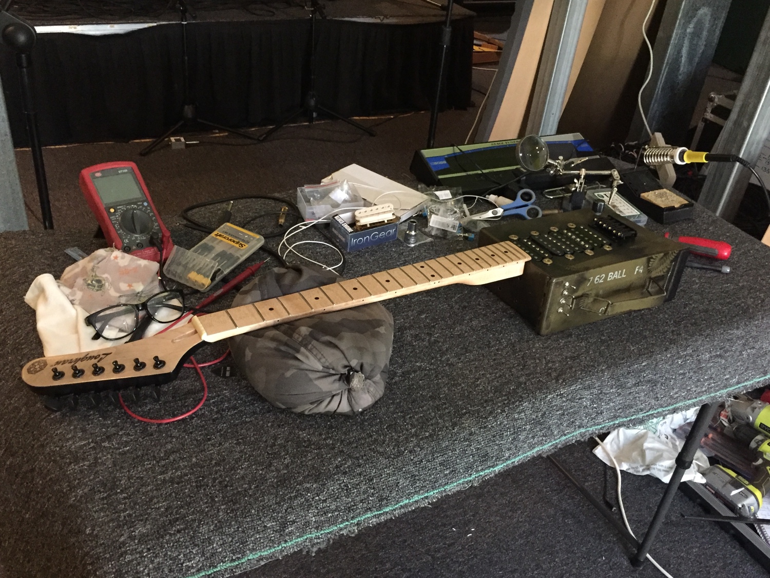

Another interesting feature are the 4 Mini Toggle switches, which offer 16 pickup configurations.
Attachment 43854
Otherwise, this guitar is quite simplistic and utilises only a single volume control. Due to the pickup selection (Roughly Hot PAF like humbuckers) and pickup placement/ pairing arrangement, the guitar is surprisingly dynamic and responsive.
Hopefully this inspires you to undertake your own custom build :)
