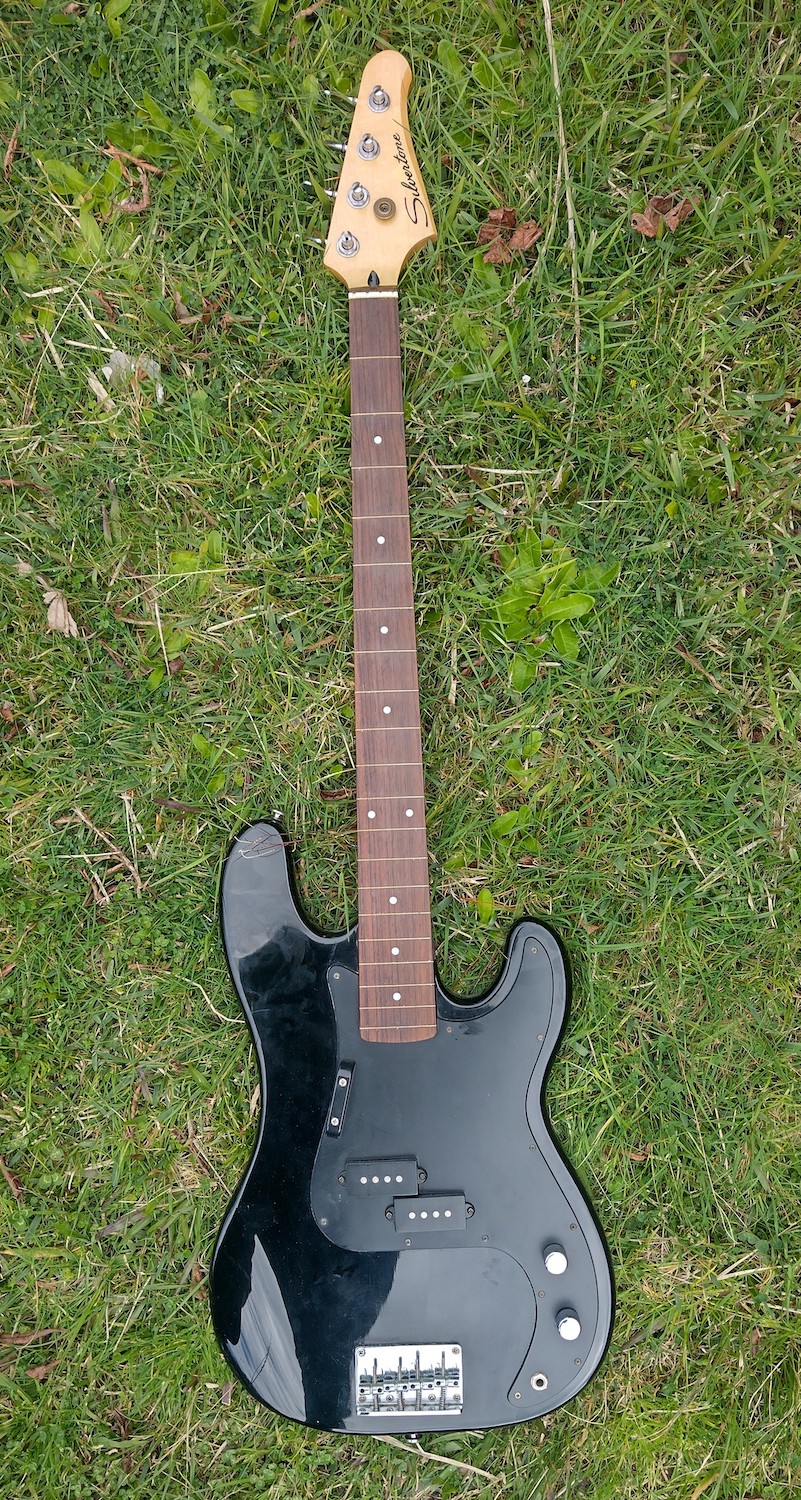

I bought a Silvertone bass for second hand very cheap (+/- 100$ au) that I would like to use for upgrades and mods.
Attachment 43475
This bass currently has a fretted fretboard that has been converted to fretless (lined) by someone in the past.
I would like to swap this neck for an unlined fretless, perhaps upgrade the pickups and do some minor cosmetic changes.
The instrument itself as it is not too bad at all, it definitely plays well, it's lightweight, it sounds pretty good with half rounds, but I really don't like the fretless lined fretboard, the headstock and the tuners.
