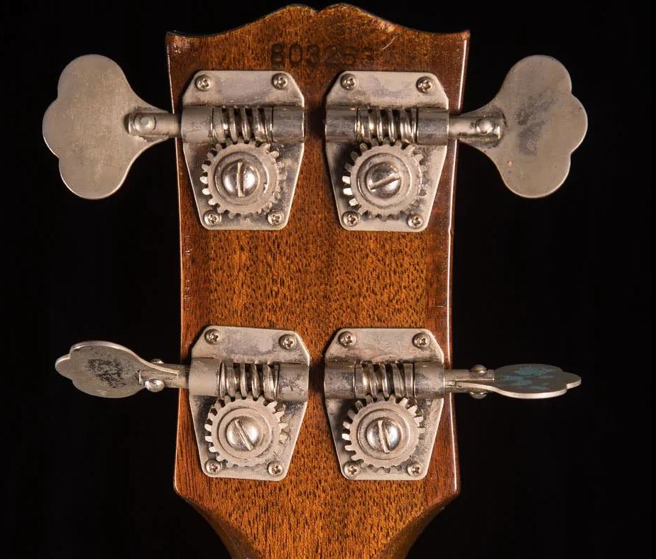

Anybody have a picture of how these tuning machines are mounted? I see there are left/right pieces but which goes on which side and the orientation of the mounting plates?

The tuning peg is mounted so that it's on the side of the tuner away from the body. Slightly less important on a bass tuner than a guitar one (as the post is wider and has more support), but it's arranged that way so the string tension pulls the top of the post, and as a result, the bottom of the post with the gear on it is pushed against the tuning peg gearing which keeps things tight and minimises backlash in the gears.
A bit of a tight fit on that headstock as the tuner bases are wide, bigger than the originals I think.
It should look something like this '66 EB-2 headstock.
Attachment 43285
1 Attachment(s)
What luck. That's the way I put them on.

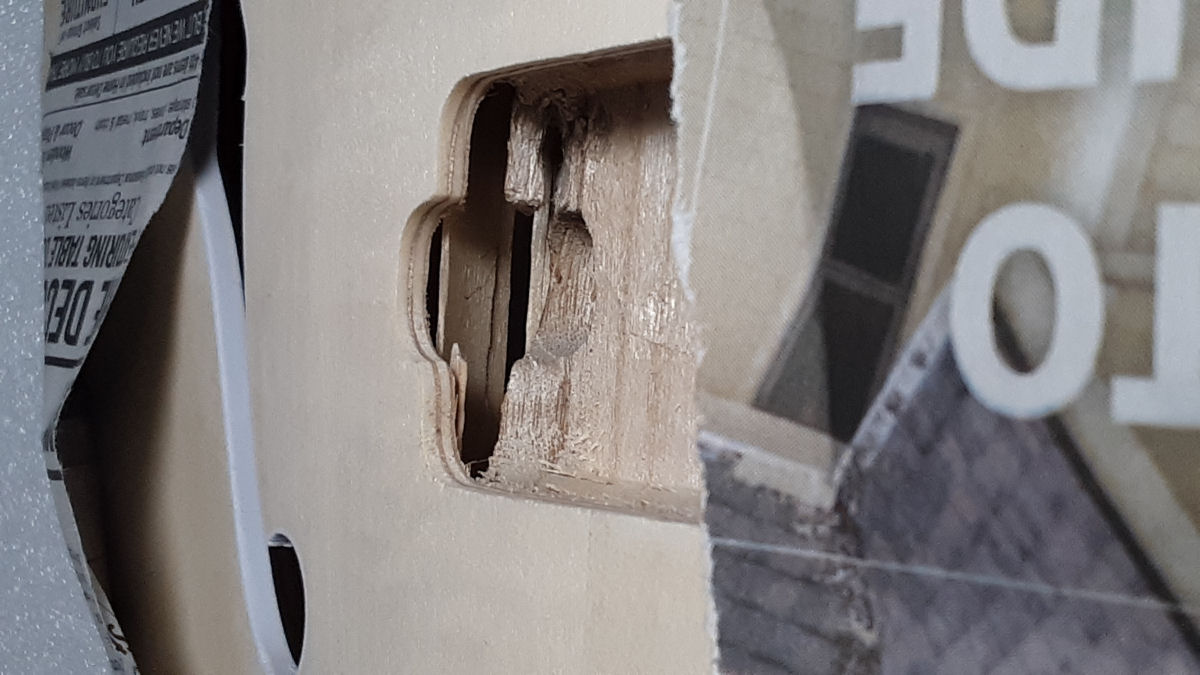

I'm leaning more and more back the thru-the-body ferrules. The screws from behind might not have enough of the center block to bear against without crushing the body. The entire interior on the control side is a mess of splinters. Looks like a perpetual buzz. Looks like a whole lot of problems would go away if that block was wider at that end.Attachment 43286
Well, I finished the beast. No buzzing from the splinters but several frets need some work. I ended up epoxying the two rear bridge bushings (one of them had no support underneath the guitar top) and no string through ferrules. So far so good.
