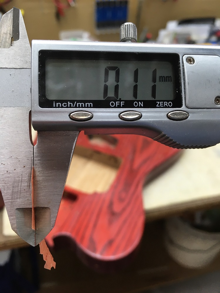

Originally Posted by
Dikkybee007
I think your decimal point should be moved one step to the right as my paper measures roughly 0.1mm and most digital calipers only read to the second decimal point.
