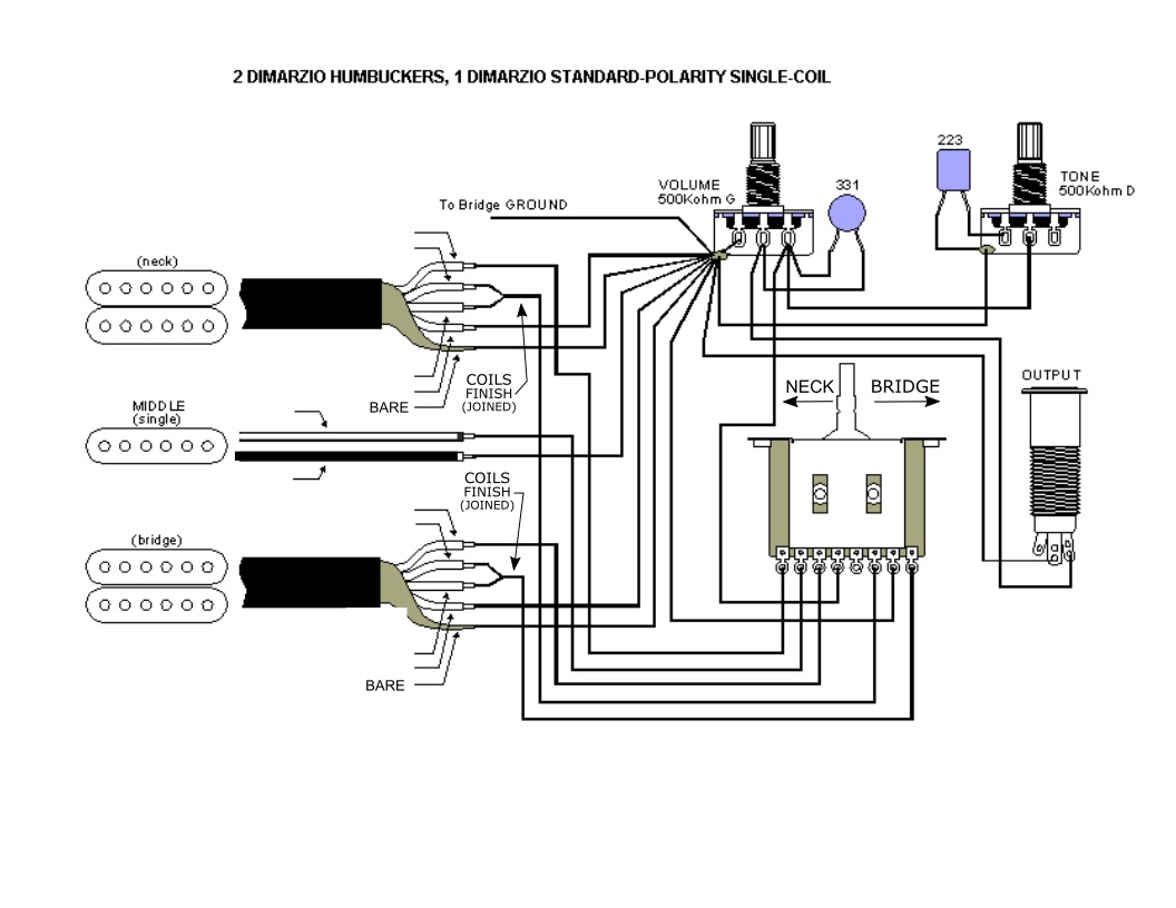

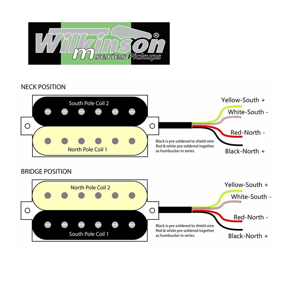

Have a pick guard and installing wilkinson M series Pickups
I know the picture is distorted, however the setup is HSH, the old neck HB is still in the guard as I haven't installed the new ones completely into the guard. The middle is new and Wired correctly, however the neck and Bridge I am not sure about as the small yellow wires are top=Neck Bottom=Bridge. What I want to make sure of is that it's wired right and when I go to select them I'll get the full of each bucker and not a single. These are a matching set of Wilkinson pickups which I bought to go together from Amazon. I know I could have kept the original ones, however I figured it would be better to just replace everything and match them to be sure of no imbalance. I'd appreciate any and all advice and if I should move the wires to the same spots as the other two wires for each HB respectively. the Neck is the yellow/white large wire, the bridge is the red one with Red and white. I don't want to blow up the pickups the first time I put the guitar I am installing the guard into on an amp. This is also an Ibanez setup, so I don't just want to screw up the harness.
