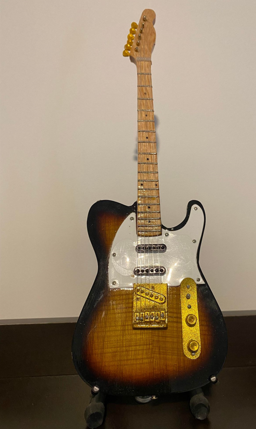

Here is a photo of a replica that he has sitting on his desk guys. Many thanks already
Wow! Apart from being a lefty, there's a striking similarity between RocknRolf's and the desk-sized one!
As for videos, there's an American guy that does a number of stain bursts on YT. I think he is Big D Guitars or something like that.
I'd go with a stained body and then a sprayed burst. It isn't hard to do with a rattle can, and it's a lot easier to get a nice gradual feathering from dark to light with a spray. Whilst it is possible (as RocknRolf shows) to get a good gradual blend using stain, it tales practice to do so, and at least 90% of the one's I've seen on here have ended up with a definite line between the two (or three) colours.
But it all comes down to what you feel happiest doing.
It does ay! This one has a sprayed black, perhaps even red underneath the black burst, I think.
