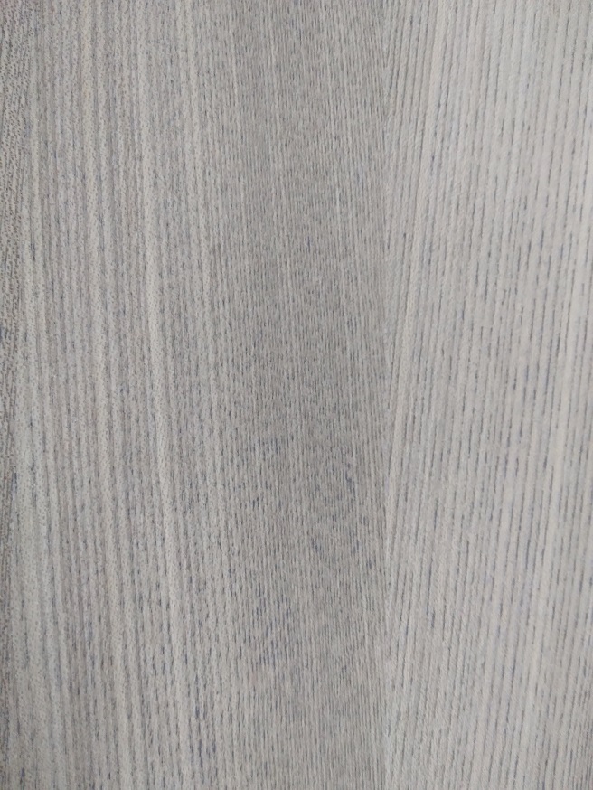

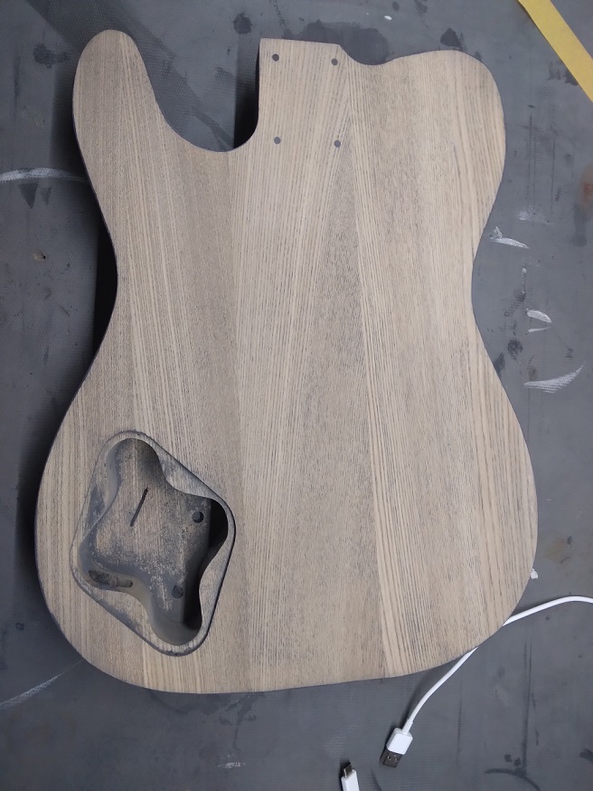

Despite working on 3 projects already, I purchased a TLA-1 build several moons ago. I decided to finally get moving on this one as I need to take a break from another build lol. This will be my first attempt using an ash body, so I want to do it as properly as possible. Below is my plan, if do-able, and would love some feedback as you're all much more experienced than myself!
-Grain fill first. I am hoping to use white grain filler to have lighter lines in the grain, and then use either phthalo blue or royal blue. Would that just turn the applied white grain filler blue? Or could I stain first and then grain fill?
-Stain next
-Sanding sealer
-Finish
Mahogany is the most grained wood I have used so far, and I have typically left them open grained, but want a nice glassy finish for this build.
Thank you to everyone in advance for any assistance! I forgot to take pictures last night, but will update once I have some ready to go!
