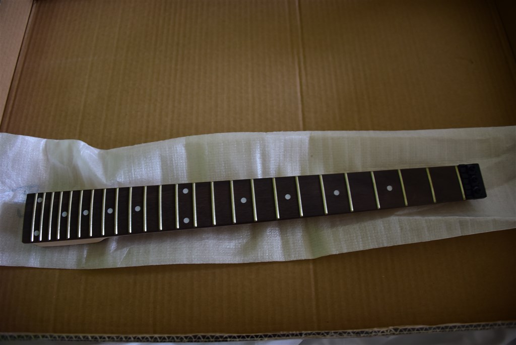

The neck looks to be OK, probably will need a fret levelling when completed and a tweak on the truss rod, but that is to be expected as even new Fenders and Gibsons need that all too often.

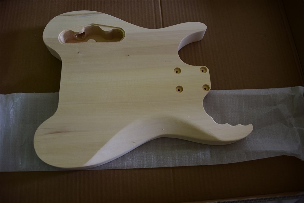

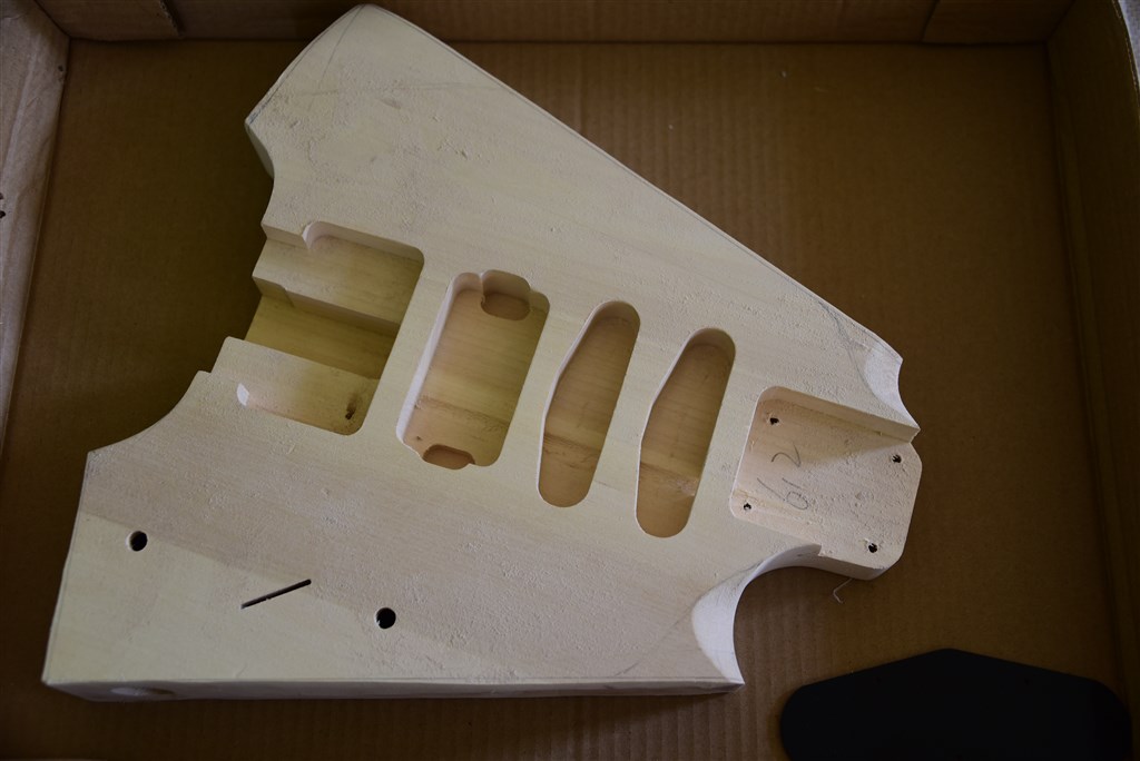

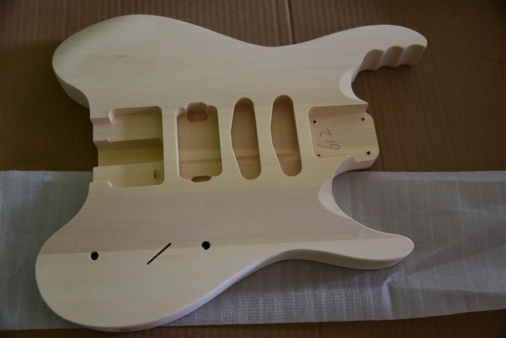

Body looks OK, but that is going to get a lot of tender loving care from various tools so any minor imperfections will vanish in a cloud of sanding/saw dust.
Neck/body joint is over tight, with the neck about 0.5mm wider than the pocket (it's a screwed on neck). Easy to solve and better that way round than the 4mm of packing on width that was needed on a friend's bass (not from PBG).  Not able to comment about alignment yet as I've not got the tools and sandpaper out yet.
