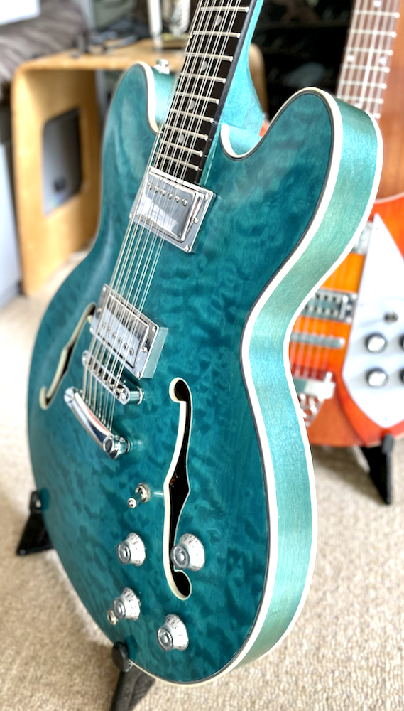

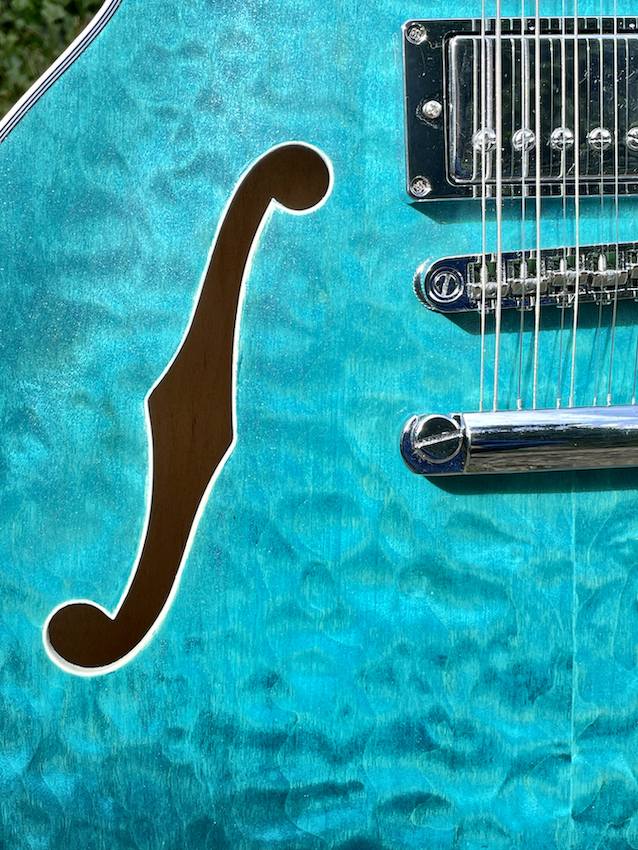

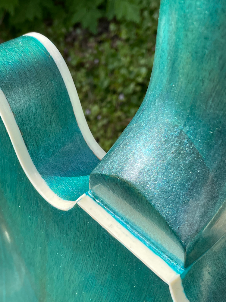

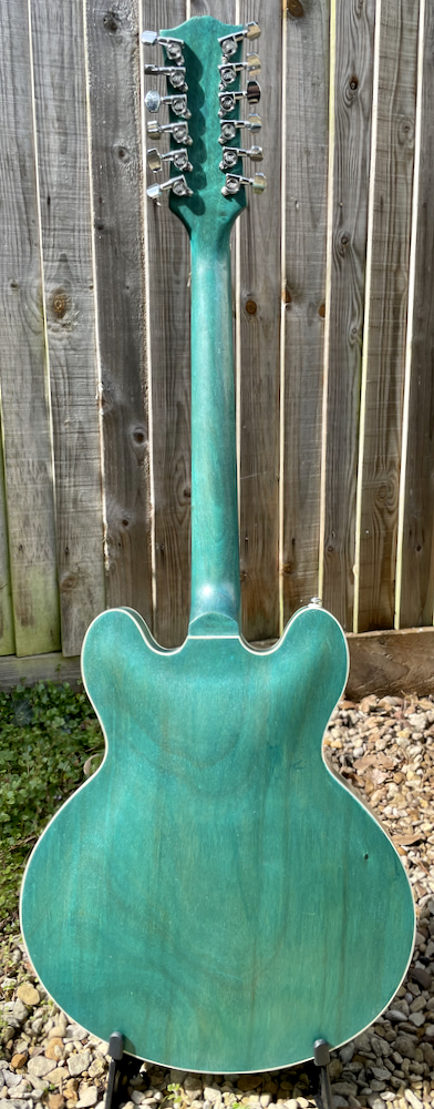

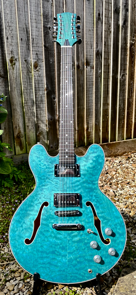

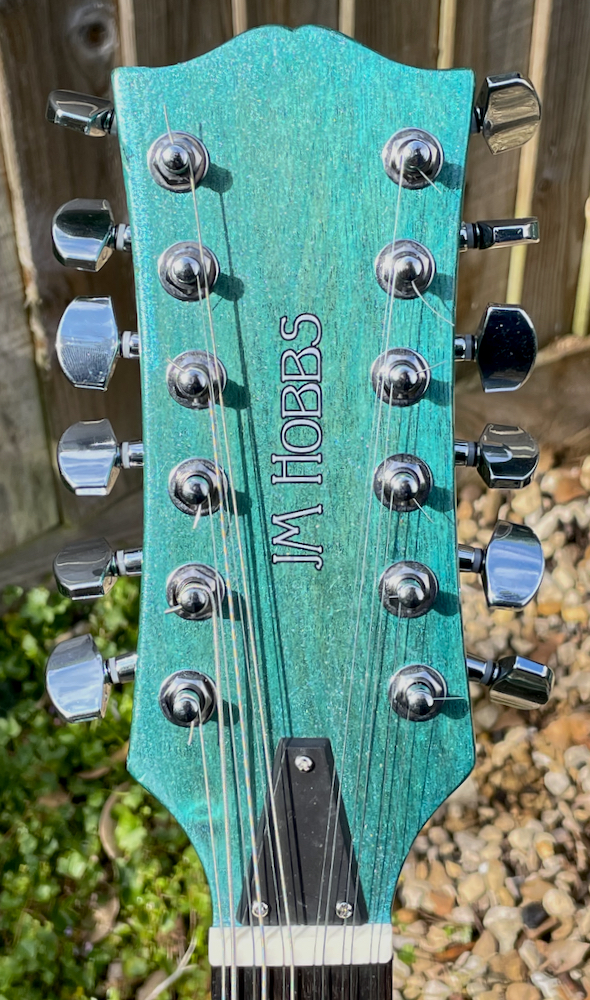

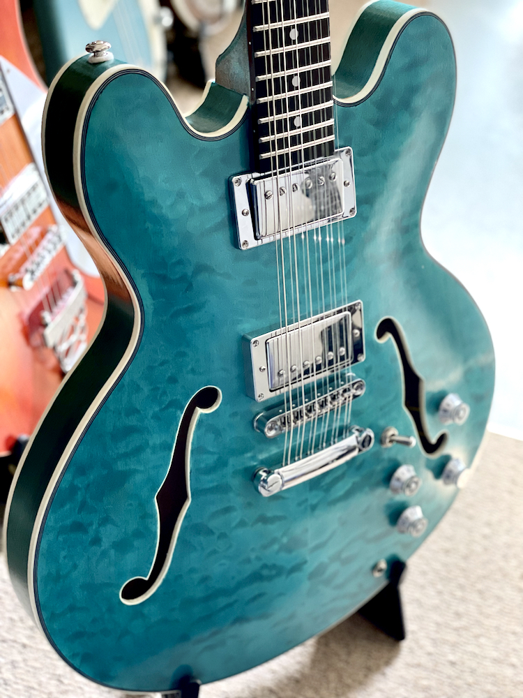

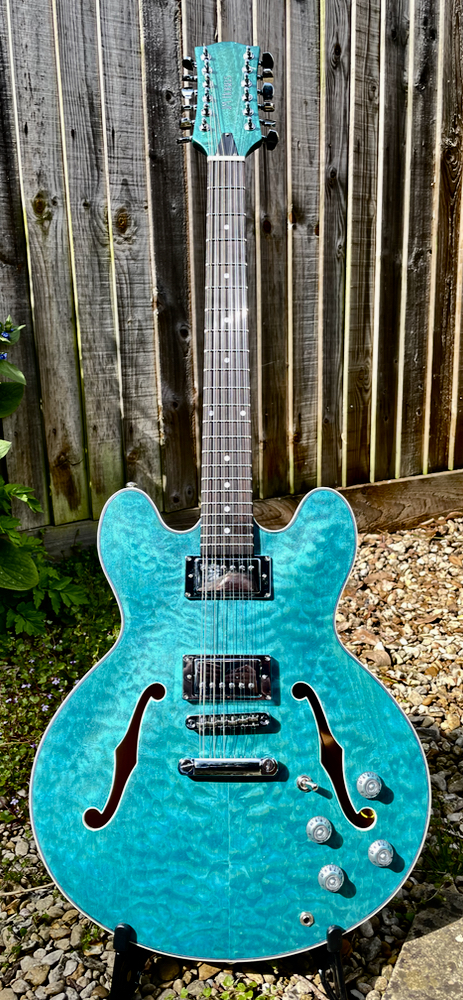

ES-12Q - modded
Here's my entry, finished on the 2nd of May.
An ES-12Q.
Specifics:
Wilkinson tuners
Tesla Shark humbuckers from Iron Gear
KAISH tuneomatic piezo bridge that I converted from 6 string to 12 string
Kluson rimless bridge bushings to compensate for the greater height of the piezo bridge and the too-shallow neck angle of the kit
No name tailpiece
No name toggle switch
3 IKN push/pull pots - coil splitting for the humbuckers, on/off for the piezo
Stock pot and cap for the master tone
mxuteuk witch hat knobs
Generic 1/4" socket
Copper shielding tape in the pickup routes
Finish: Wudtone Azure Lagoon with silver mix-in highlights and extra gloss top coat

Nice work J, that colour is really nice and looks great on that quilted top. The way you have splayed the tuners is a bit different, I also found the tuners a bit close on my ES-12G.
Thanks! I splayed the tuners both for practical reasons, and because I thought it would look interesting.

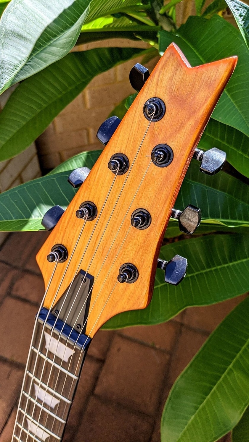

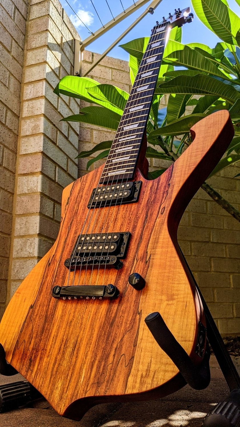

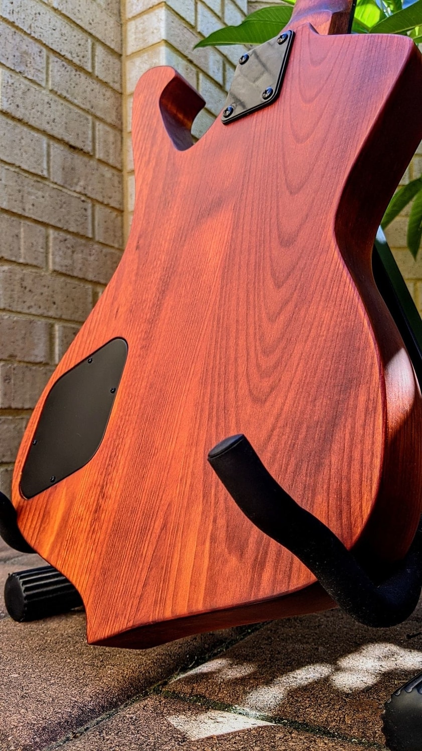

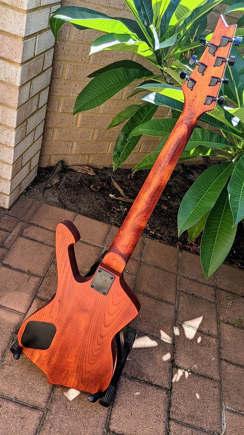

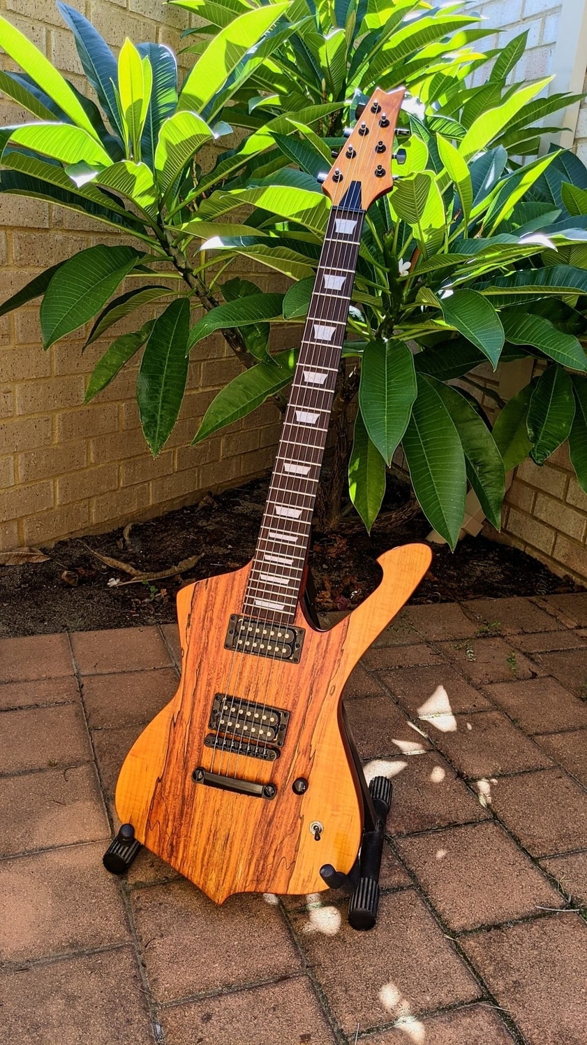

Custom IC-7 String
Here is my entry for GOTM, finished on 5th of May
Specs:
27” scale length
Basswood body
Spalted maple top
Maple neck
Rosewood fretboard
Tune-o-matic bridge
Single volume knob with 3-way selector
Attachment 40472
Attachment 40473
Attachment 40474
Attachment 40475
Attachment 40476
I stained the whole guitar with Colortone Vintage Amber stain and then used a Feast Watson Maple stain on the back over the top of the yellow, i think it worked nicely.
Finished with boiled linseed oil and a couple of very thin clear coats on the top of the body and headstock for a slight sheen.
The 27” scale length lets me get away with using a relatively light set of strings (9-52) for standard B and drop A, as well as having appropriate tension for my play style.
The factory forgot the routing for the pickup selector switch, but as it happens i wanted to change the location of it anyway so it worked out well.
The headstock in the image look ginormous but that's just because of the angle of the photo, it's quite a reasonable size.
Future upgrades will include a graphite nut and some locking tuners, possibly a new set of pickups.
I have always loved the IC shape and so happy to own this, super impressed by the quality of work by Pitbull guitars.
Love seeing another IC build, great job. Love the binding and gold hardware!
Is that not a flame maple top though?

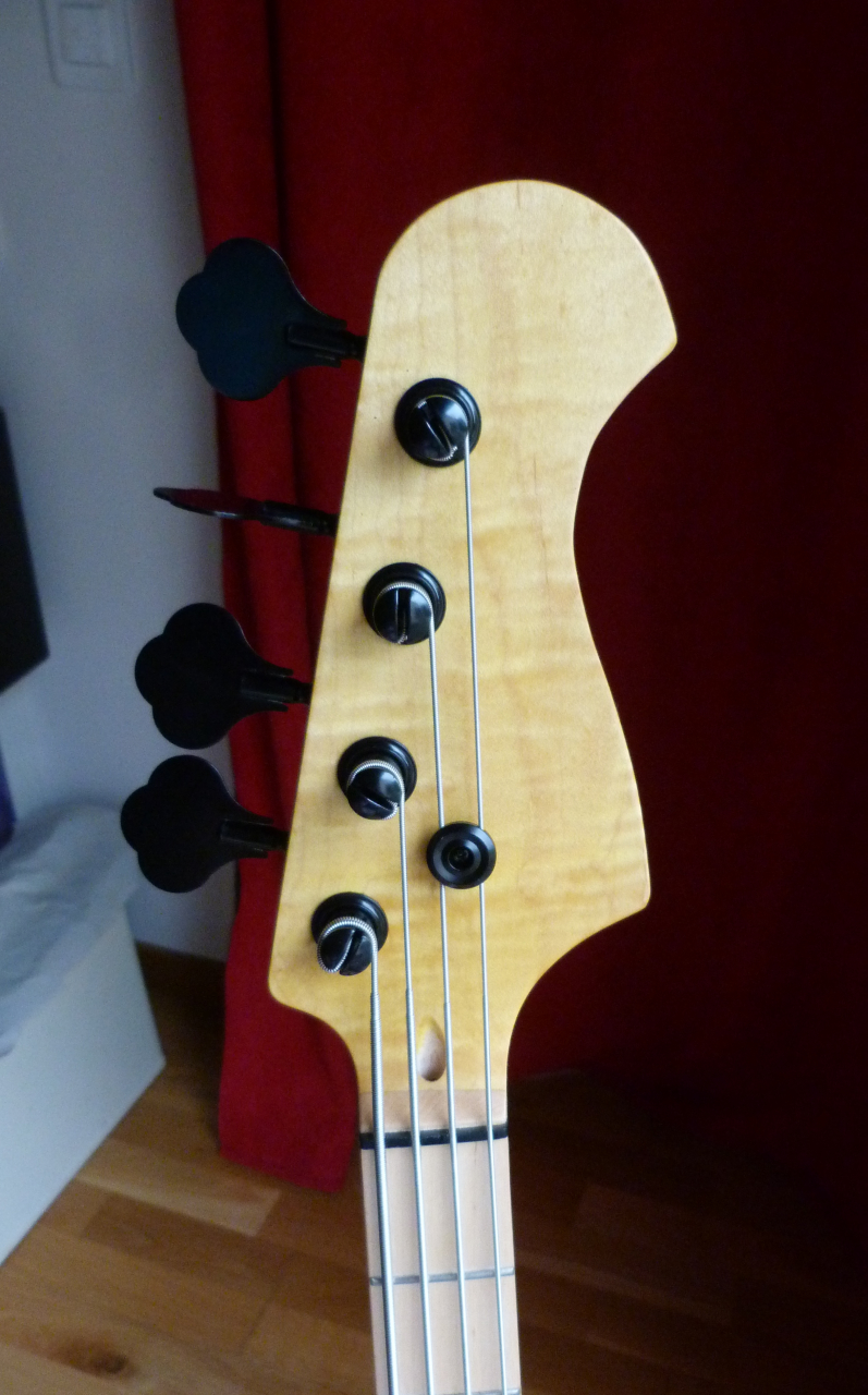

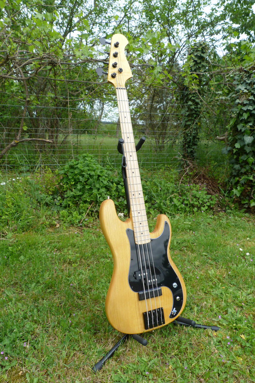

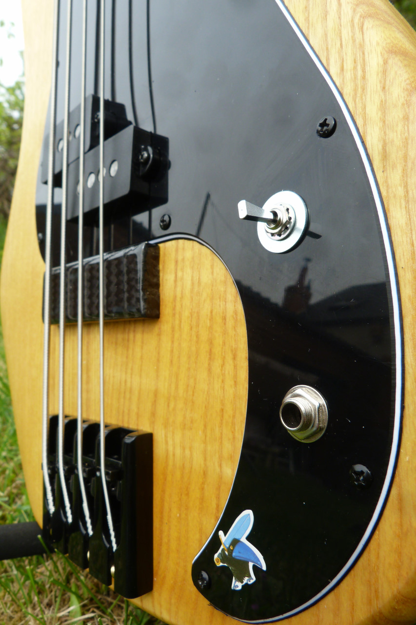

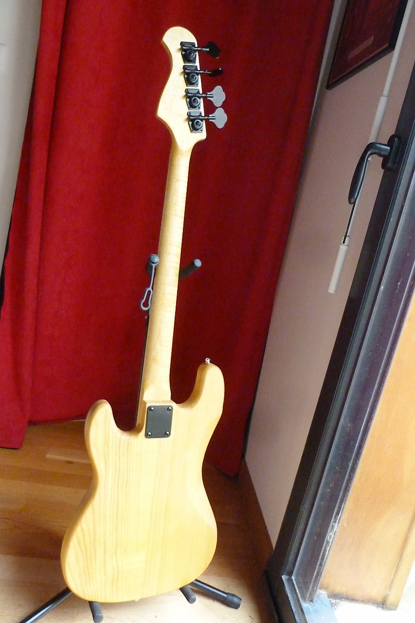

Hi everyone !
Here is my first Pitbull bass guitar, it's a GPB-4M with black hardware.
- BEAD drop, so the nut has been modified for the bigger gauge
- Seymour Duncan SP3B pickups + Homemade wiring --> microswitch CLEAN / OFF / FILTERED (capacitor)
- Copper Shielded cavity
- Homemade carbon thumbrest/fingersboard
- Göldo heavy bridge
For the finish, it's a nitrolack yellow stain + True Oil
Since it was my first "real" build from scratch, I did learn a lot with this kit. It was kind of scary some time, afraid of making a mistake but in the end it was totaly worth it !

Thanks for your comments !
