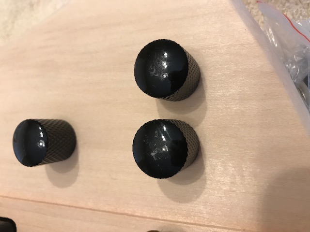

I received my kit and extras in very quick time, particularly impressive since I live in the North of Ireland! All was in order - I did a rough assembly to see if I had all the parts. My only issue was that the knobs had been packed/come loose and were scuffed.
Attachment 39126
However. more amazing service, replacements were sent and arrived within days! Thank you Pit Bull, well impressed so far! :D

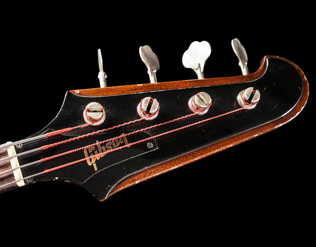

I am filling the time waiting with research. I would like to reproduce the two-tier headstock cover used by Gibson for the early TB's - the hockey stick faceplate and the overlaid truss rod cover (minus the Gibson logo). However, I cannot find a template for these nor can I find an easily obtainable example. Does anyone know where I might find a template?

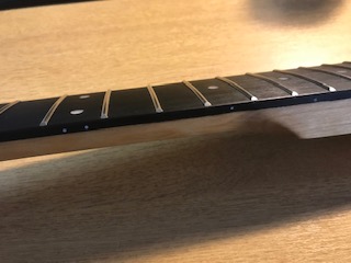

Well, I have decided on the headstock treatment. I am going to apply an ebony veneer and shape this to provide the 'rebated' headstock detail I am looking for. I have taken a template from the headstock and drawn in the 'rebate' to provide a template for the veneer. This required some adjustment as the tuners are closer to the edge of the headstock in the kit neck than they appear to be in original (not that I have a 1964 Gibson Thunderbird to hand).
Attachment 39306
For the ebonsing, I used Angelus Leather Dye- this stuff covers unbelievably - the merest dip of the swab and I was able to treat the entire fretboard (I will confess, I practised on an old acoustic first!). Now I must resist the temptation to press on and let this dry before applying the oil finish. Very little bleed past the masking tape - easily addressed by a razor blade - not the case on the practice attempt - but that is what practice is for!
I will, either; hold off on oiling until I have fitted the headstock veneer; Or, keep the headstock masked when oiling the neck. The former is the right thing to do, the second panders to my impatience.
