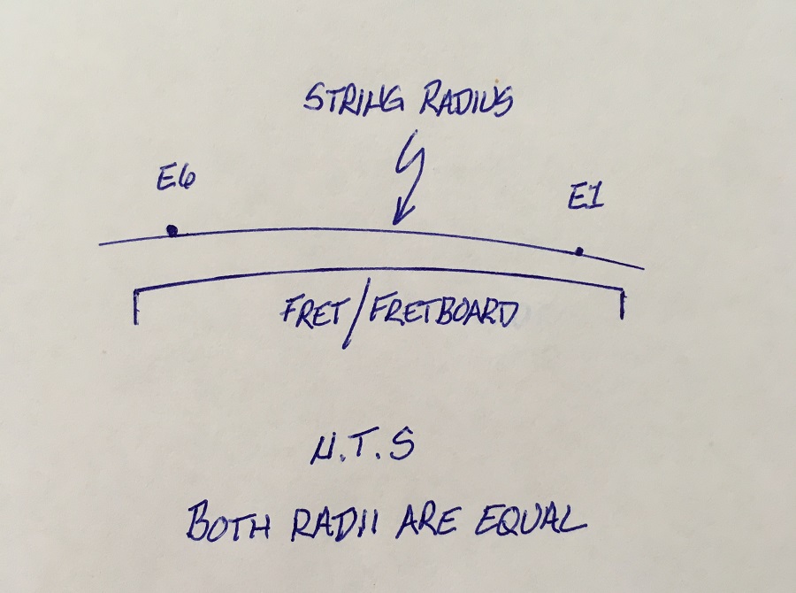

I am levelling frets on my current build and decided to use my radius block to level them. This idea started when I discovered the bridge itself is a 12" radius, not flat like my others. I thought if level them flat, I would have high strings in the middle.
Is this correct? Should I go back and level them flat?
