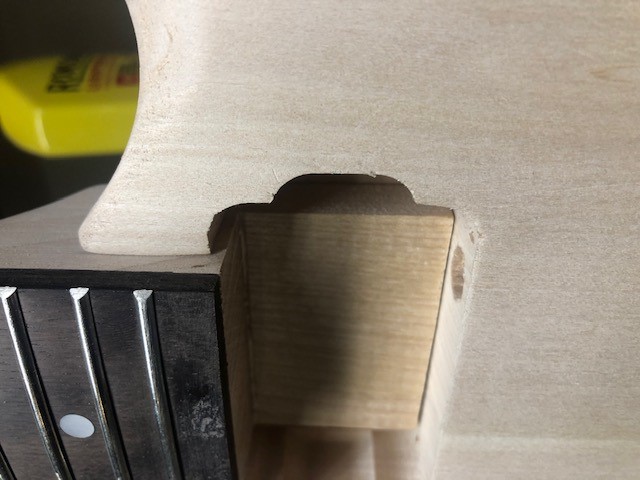

Managed to dig up my AG build
https://i.imgur.com/ZtpeBrB.jpg
This is how the neck ended up in mine.
https://i.imgur.com/rk6BLjO.jpg
Also, just be careful when glueing and clamping, You want to make sure there is enough break angle on the neck. If you clamp too hard on the tang of the neck you can greatly reduce that angle which will cause action problems later. Good contact at the heel is the most important.
You can check the break angle with any straight edge like this with the neck clamped.
https://i.imgur.com/BZcdnua.jpg
Different guitar in that pic, but same principle - you want room to have the bridge posts wound out a bit so the bridge sits up off the body.
