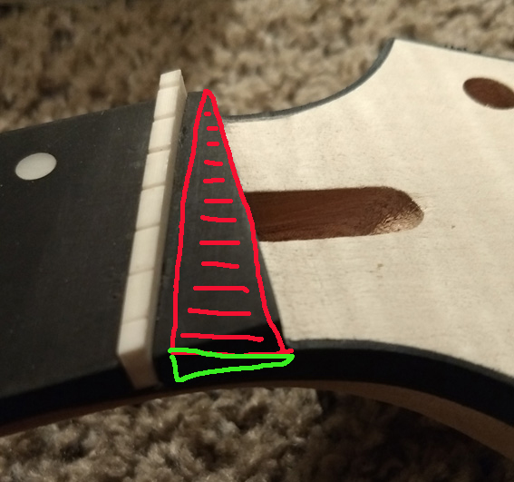

On that bit of the fretboard past the nut I'd definitely be taking a file to that to angle it down the headstock. So that there was a triangular facet with one side that ran parallel to the nut, one side that went from that parallel point at the lower side right to the headstock, and the third side heading back up to the current end of the fretboard.
I don't know if that made any sense at all.
2 Attachment(s)
Like this?
Attachment 37555
But note that will really require a custom-made truss-rod cover with the fretboard-end angled and sloped to match the slope of the board end. Just leaving a standard truss-rod cover end sticking up vertically against the sloped rosewood will look odd - though the current arrangement looks just as odd.

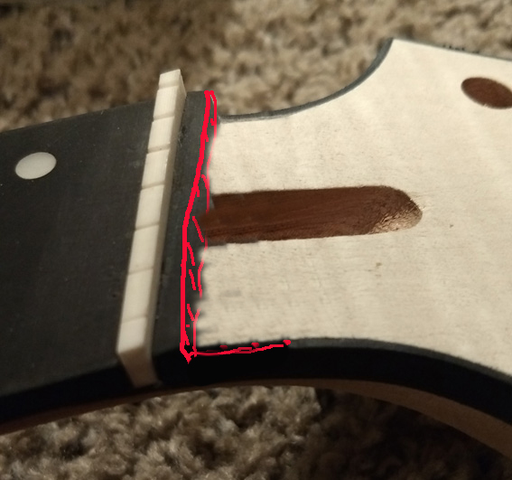

The black binding to the headstock makes any other alterations to the headstock a bit more awkward. Without it, I'd cut away the excess board parallel to the nut, but not slope it, just cut it level with the headstock, then glue on a piece of suitable veneer to give a unified headstock face.
More like this:
Attachment 37556
But that does leave the black binding sitting below the veneer looking a bit odd in itself, unless you then paint the very edges of the veneer black to match.
A fair bit of work.
Yes, that was what I meant Simon, but I hadn't thought about the truss rod cover.
Still, good excuse to make a custom TRC! :)
In fact with either your or my suggestion, or even as it is now, a custom TRC might be the way forward and use that to make the link between headstock and neck.
Any solution for that bit of fretboard seemed like a lot of excess work for little gain, since I'm not confident I'd get a result that looks any better than it does now.
