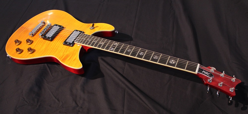

Just ordered 2x AG-1F kits. Currently on backorder but supposed to be coming in this week. One of these I'm building for a friend but I got so excited about the prospect that I decided to build one for myself at the same time. Got a set of Tonerider AC4N for mine and two lots of Dingotone Uluru Red. This is the kind of look I'm going for, not sure how close I'll get - it's difficult to gauge what sort of colour I'll get from the images on the web site.

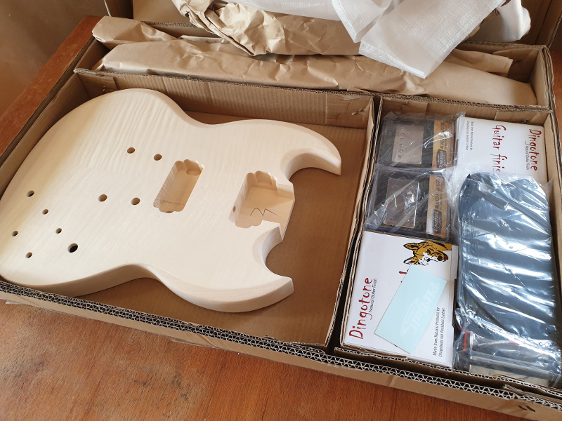

1 Attachment(s)
Happy days - shipment arrived today. Expecting two boxes and only one arrived. Delivery guy said it's a short shipment and I'll probably get the other box tomorrow, however the tracking now has the whole shipment with a status of delivered which is a little concerning (already logged a ticket with Aus Post).
Attachment 37183
