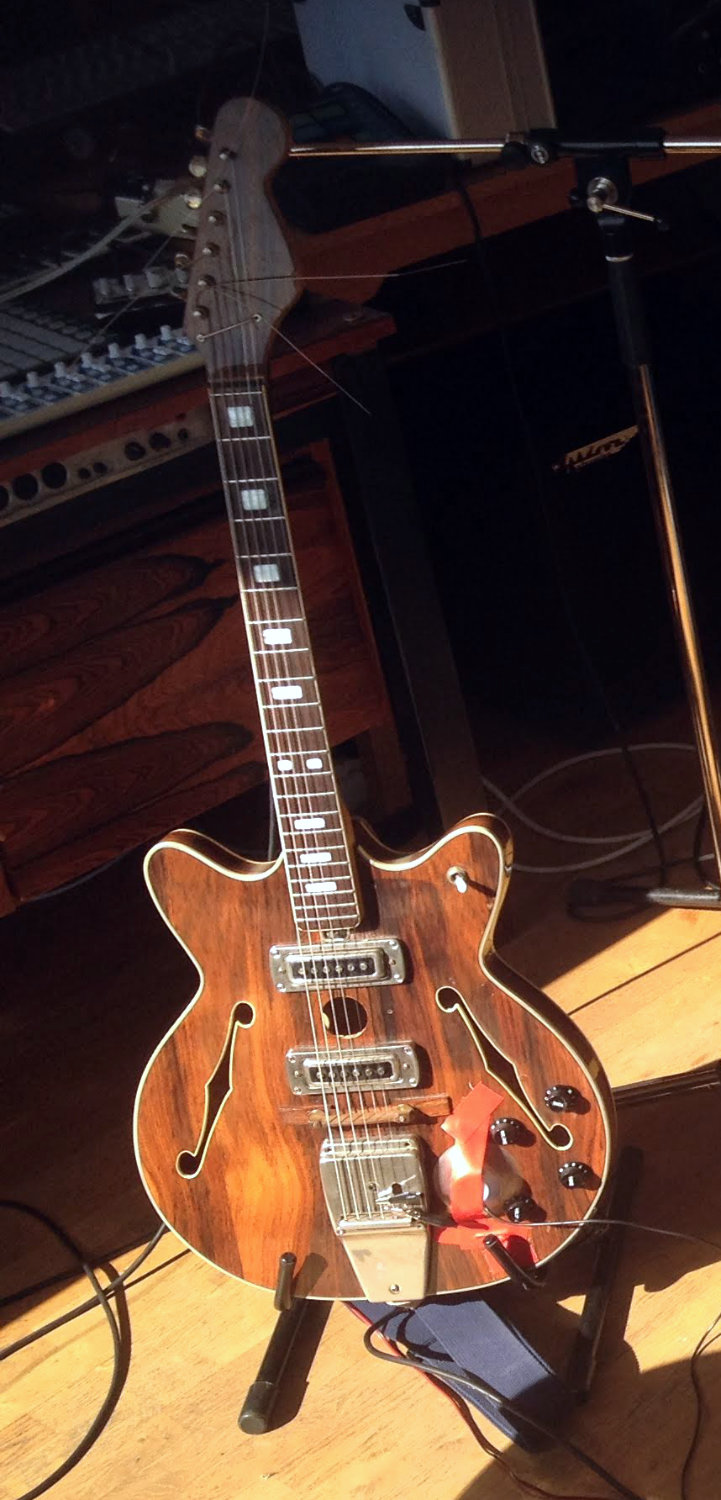

Hello. I am looking for a Fender Coronado copy, I have a Teisco Coronado. It's a bit cracked and abused. A luthier replaced the neck with a stratocaster type neck, So I've got the spare neck, but would be nice to have a kit type body to go with it. Thanks alot. HallvaršurAttachment 45097
Looks a bit like the "wildwood" Coronados. I had in mind doing something similar with a bass. My "Laureado" bass uses a Fender Jazz bass neck and an ES-335 bass body. I haven't found anywhere that sells a bolt-on thinline or semi-hollow body for a fender neck. I had to modify the body to accept a fender neck. Since the scales are different with Fenders and Gibsons, the bridge will most likely also have to move. Here's the finished product in its case...
