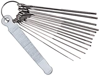

Well, you could cut* your own nut. I am in the US so YMMV, but I got a bunch of blank nuts for very little $$$ on Amazon or eBay. I was surprised that it was not very difficult to cut the nut down to size. I did F nuts and it took about 1-2 hours. G nuts might take less time since they are bigger, so not as much material to sand off. I have been keeping old plastic nuts to use as a model to get the shape and string spacing right.
You'll need to cut slots. I confess that I am about to do my first guitar nut. I have done bass nuts up to this point. I used needle files like these to cut the slots.
Attachment 35726
This worked great on bass. Very easy and quick to get the slot to the right depth and unlike other files the bottom of the slot is round. Also I think these are pretty much the cheapest option. That said, my success with them may be because I was cutting bass nuts. Bass-sized files have more girth than they would for guitar. I worry a bit that when I do my first guitar nut (sometime this month, probably) the files may be a little too skinny to cut well. Will know soon ;-)
*Funny that the process is referred to as "cutting" the nut. My experience is that the actual process is mostly sanding ;-)
